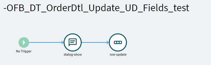

I have this (test) event, which is fired by an event-next when a OrderDtl.PartNum changes:

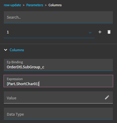

I’m trying to move some UD fields from Part into OrderDtl at that time, for row-update I have:
I have a dialog shown to stop just before the row-update so I can check the Part Dataview contents first.

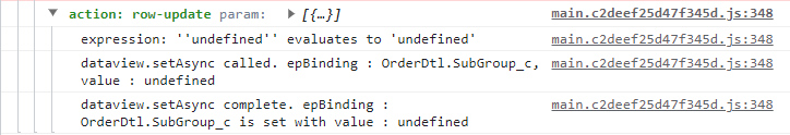

but when I trace, the debug output shows the following:
I’ve tried:
Part.ShortChar01
{Part.ShortChar01}
‘{Part.ShortChar01}’
they all give the same result

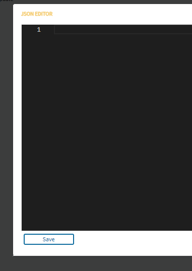

My belief is “Value” parameter is json formatted, which doesn’t seem to make a whole lot of sense here

Really, that’s “Expression” not “Value” no ?
why does it look like this ?
I’d love to understand the diff between Expression and Value useage

and you’re correct @hmwillett, I had tried ‘{Part.ShortChar01}’ in the supposed json editor and got an error on the formatting, but with “{Part.ShortChar01}” it was syntactically correct at least
