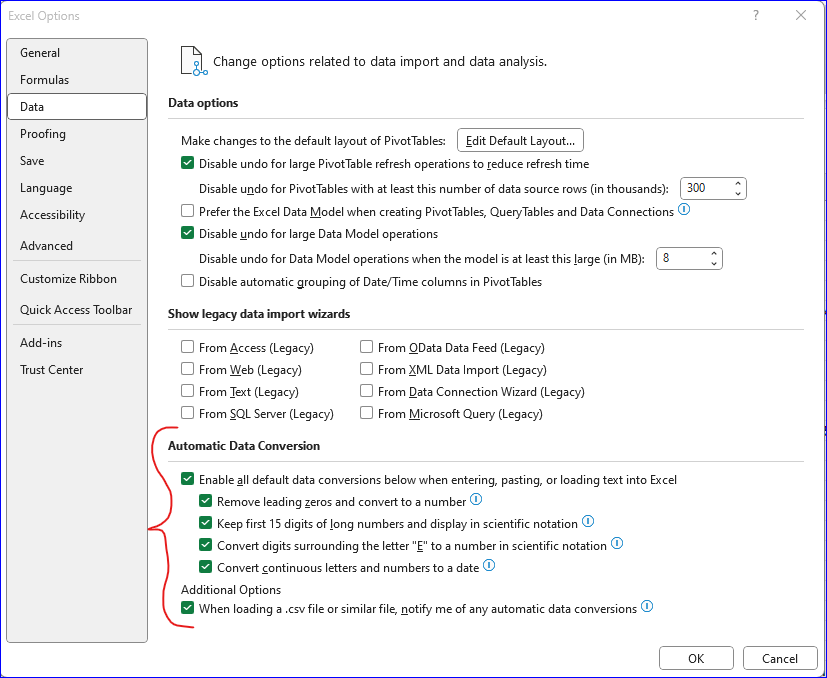

I haven’t seen anything on the Kinetic side… but you do have some ā€œfeaturesā€ you can disable on the Excel side.
File > Options > Data:
Pretty sure these are all ON by default.
This is it. Uncheck the first five, those opt you out of silent conversions. The last one does the opposite so leave it checked.
This does leave you on the hook when you do need something to be a particular datatype, but you already were on the hook to fix the incorrect helping anyway. I prefer the option that doesn’t require constant vigilance.

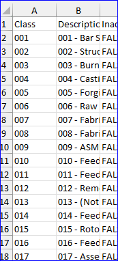

Oddly enough, I was going to test these settings in Excel just to verify it worked… but when exporting my part class list to excel it did NOT convert my part classes to numbers. And I had not changed any settings.
So… I’m not sure what causes this to happen in some cases and not others.

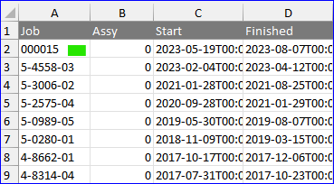

Just tested another grid real quick and it also did NOT change this stock job number:
Seems like they’re coming over as text for me:
That did it. Thanks. I hadn’t changed any of those on the local Excel because it was working on a Classic export just not on a Kinetic export.
Apparently, it is the download from the cloud that the local Excel client is converting.
Thanks for the help.
We are on 2024.2.10 cloud. The Classic exports were working correctly it was just the Kinetic downloads where you have to save the file from the notification before opening that were converting to numbers.
Unchecking the conversion options in the local Excel fixed the issue.
