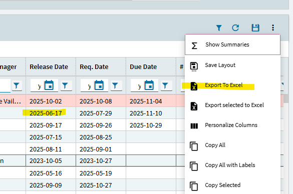

Kinetic - Export to Excel in grids have the dates with a timestamp. Is there a way to keep the date format but without the T00:00:00?
I’m talking about this option:
When opening the Excel file that was generated, we see T00:00:00 at the end of every date

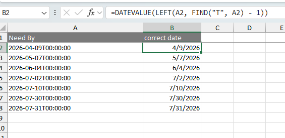

Use a custom formula in excel:
=DATEVALUE(LEFT(A2, FIND(“T”, A2) - 1))
Note careful with the copy/paste of the double quotes. they copy as curly quotes and they need to be straight.
Where A2 is your date field.

I think the other alternative to getting the desired data format is use the right click > copy all with labels instead of overflow > export to excel.
Added an idea: Customize Export To Excel Field Formats | Epicor Ideas Portal

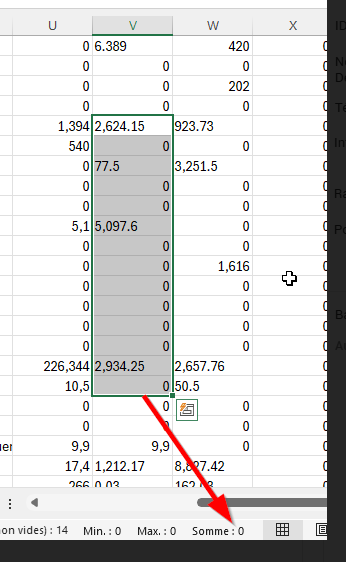

I tried this but when doing that, the numeric values are not correctly displayed. The user (Who reported me this date format problem) told me that there were problems with sums on numeric columns in Excel when using that Copy / Paste option. I was also able to replicate it myself when it was reported
What format do you have for that column in your grid options? I just did copy all > paste, and it summarizes fine:
You can see in the example some of the numbers are left justified, and contain a comma. These are likely being brought in as plain text, and Excel just can’t handle it (without some extra clicks). You can define those fields as all numeric, but you have do it manually in Excel after you paste (look for the drop down that shows up when you paste).

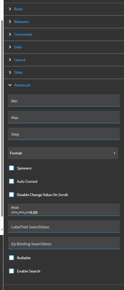

I usually have this format: >>>,>>>,>>9.99
Because it looks better in the Dashboards ! But I understand now that this format is the one that causes problems in the Excel file

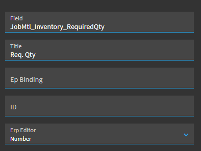

But do you have the erp editor set to number on that column in the grid? It doesnt look like it?
No that doesn’t work to get rid of the time portion.
Yes:
This is what is configured on all of my number columns in kinetic
And after the copy to Excel:
What is the data type on that column in thr baq?
Check your Automatic Data Conversion settings in Excel, it might be trying to help you. Try it with it unchecked if not already
