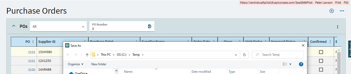

We normally can export to Excel from Epicor and Excel opens right up from a classic screen
In Kinetic, when we chose the “Export to Excel” option it always just prompts us to save the file first, which is annoying. Is this a setting somewhere we can change?

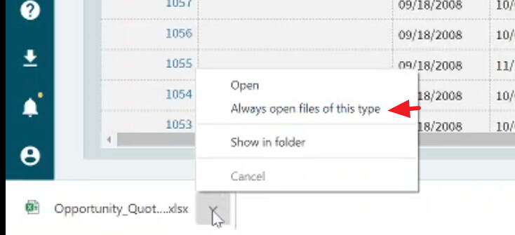

The reason that in the new web based UI we don’t open files up automatically is because that’s not something websites can force for security reasons. Websites can send you a file to download but they can’t force you to actually open it or run it instead they ask you what you want to do with the file so that say websites can’t send you surprising applications that just start running unexpectedly.
But you can tell the browser - i want xlsx files to always open immediately in excel and get the same experience it just takes selecting a quick option after you download one time. Here’s chrome for example. I have my xlsx download from doing an excel export and can tell it to just open these files immediately in the future. If you do this once it’ll just open excel the next time you do it from our app or any other website so you can get basically the same experience.

Thanks for replying. We actually don’t use the web based version. We are cloud based but use the installed version. I don’t see that option to select from your screen shot thru the installed version, it just automatically forces up the “Save as” window.
Any ideas?

Ok you have a point there which i’m going to go investigate if we ought to change in the software. We control that embedded browser ourselves including what happens when it downloads a file it probably should expose the same option as chrome at least.
Thank you for considering. It would be a big adjustment for our users since we only user the installed version.
