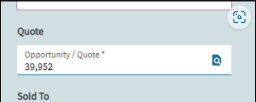

Hello,
Is there any way to change this issue? Our quote number are all showing in comma separate, Can we make it just numeric value ?

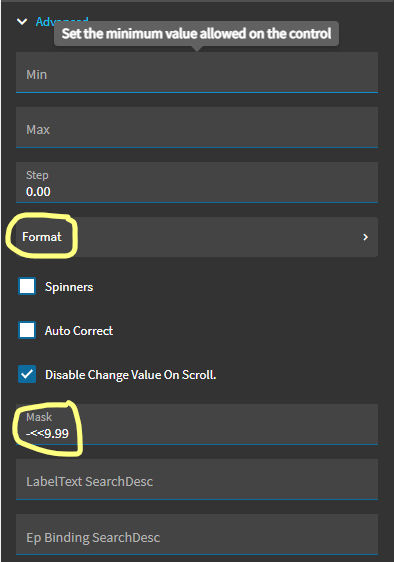

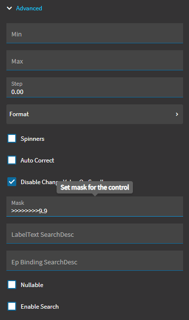

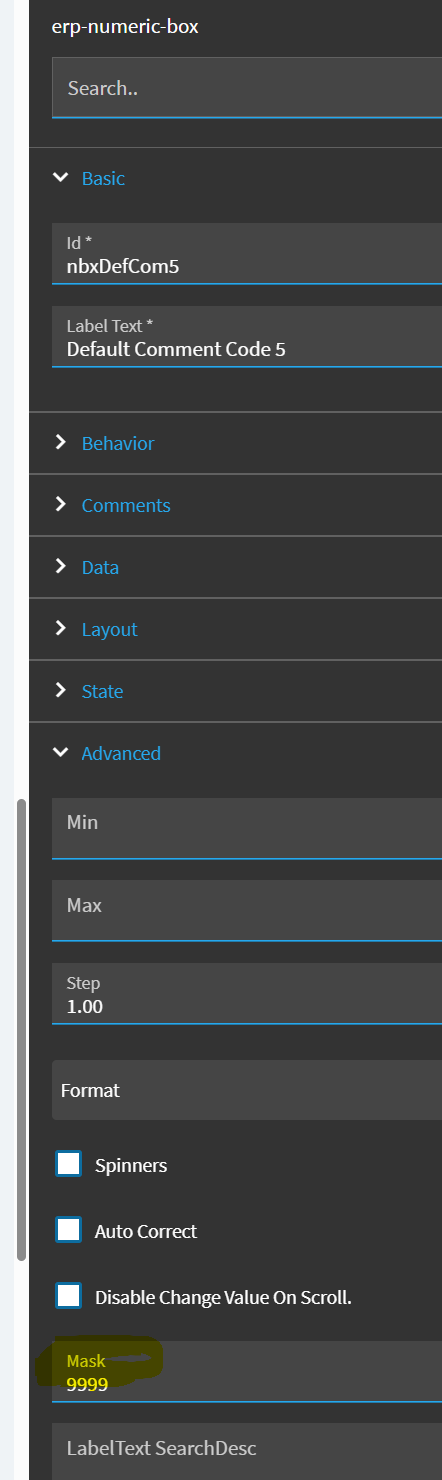

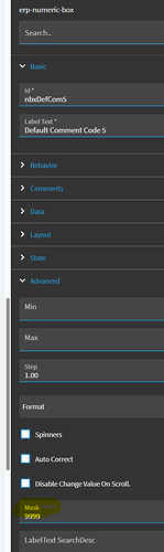

Numeric boxes have a Mask field that you can set like >>>>>>>>>9
(For this one, I wanted it to have at least one decimal place showing, hence the .9 at the end)

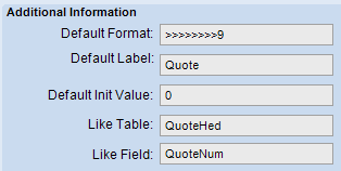

Extended Properties:
QuoteHed > QuoteNum:
So, by default, QuoteNum should NOT include commas.

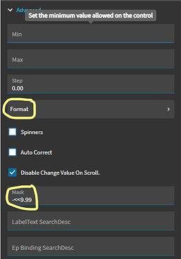

  • There is also a “Format” option on a numeric-box (which I’ve never played with to be honest), but it may impact the results as well…
Our quote screen is customized one and our version is 2023.2.11
I don’t know if it is deprecated or subservient to some other setting, but in my experience, the Format section seems to do nothing…

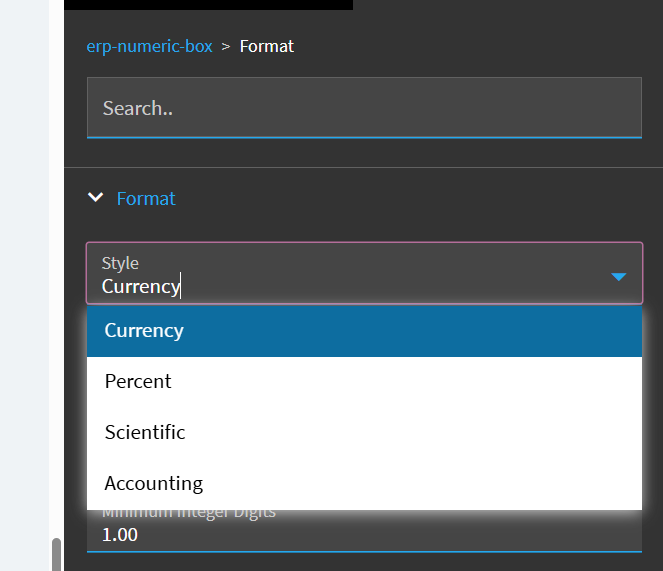

I doubt it will help as all the format option are terrible for just a vanilla number but the Source of the formatting is here from what I can tell.
2 different ways to display currency.
I feel like I am fighting with Excel again. They either need a Number Option or a Use Format Option. We are Piloting 2025.2.6 and I am going to replace these with text boxes for now.

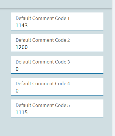

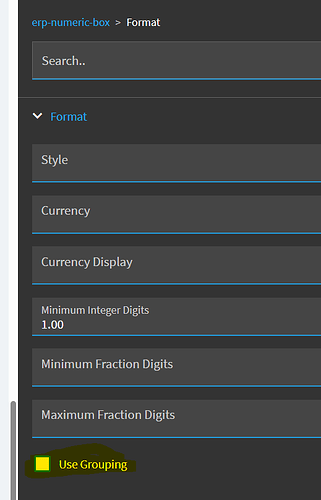

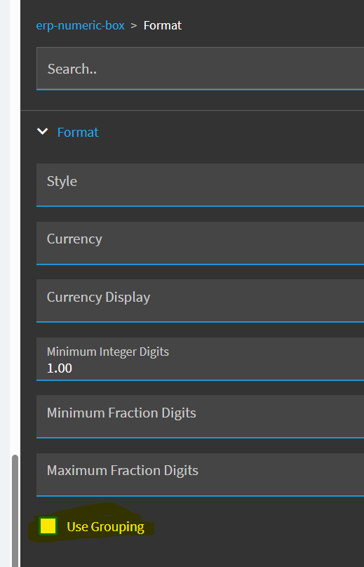

Ok so I spent a little more time and found a Work Around that will make Numeric Boxes follow your Mask defined in the Base Parameters. It is fairly simple and has worked for me in a couple of places. In Formatting Click the Grouping Check box and save your layer. Then uncheck it and save again that is it.
If someone else can confirm that would be great. I tried multiple combos after I got it to work accidentally and Grouping seems to be the key.
