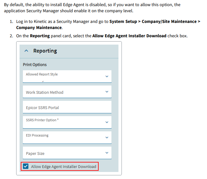

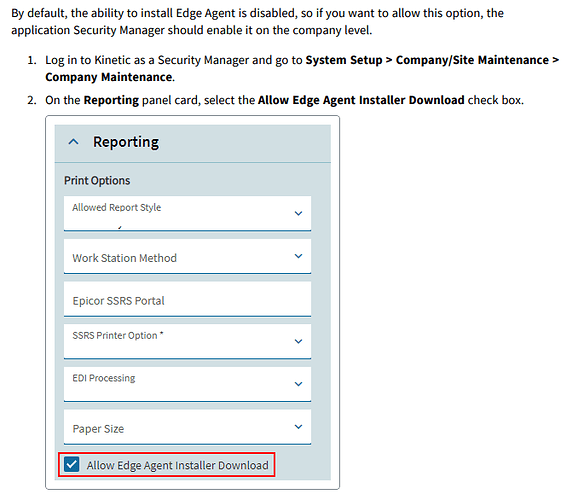

There’s info in the Install Guide (around p125)
It has to be enabled before it can be downloaded and you have to have admin privileges to install it.
