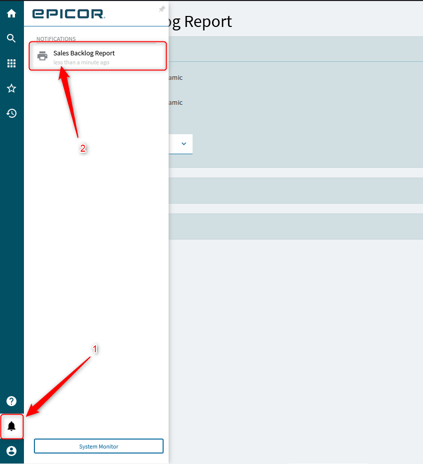

Generated reports/PDFs can also be downloaded/viewed from the notifications pane when just using the browser. It’s not as seamless or as efficient as the Edge Printing option but it is still not too bad for low volume report generation or testing purposes.

Mr. Callum: Thank you for the tip. I did not realize the “Notifications” icon is essentially the system monitor. Thank you, that will work for now.

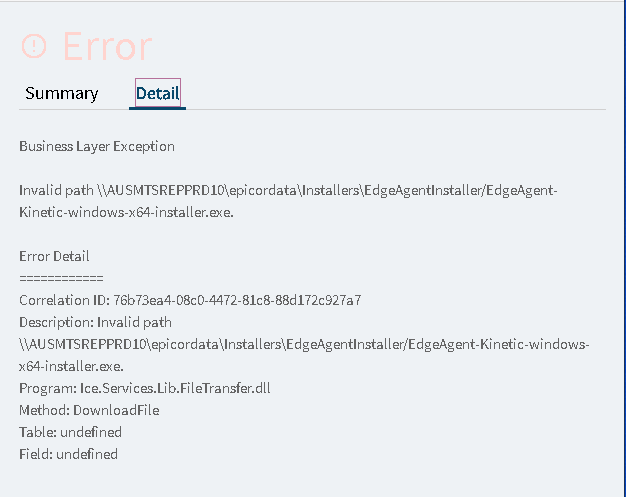

Downloading the Edge Agent install - gives an error.

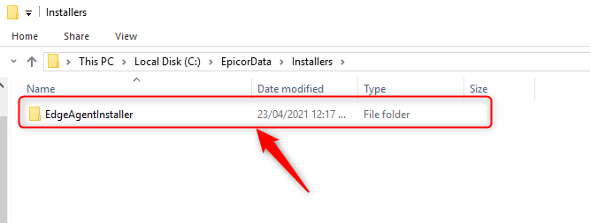

Perhaps check to see if the installer is in the expected location on the server and that the ‘epicordata’ folder is network shared and accessible by the client machine. When I tried setting it up following the Epicor help instructions on two machines it didn’t work for me but I also didn’t spend too long trying as am happy to just use download reports via the notifications pane for my current ad-hoc development/testing reporting use cases.
