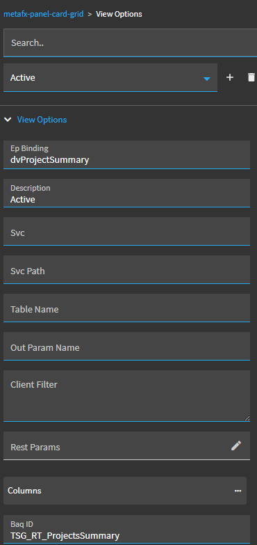

The dataview definition looks like this:
The grid calls the BAQ directly from a View:

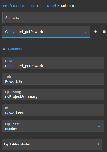

And the columns are defined in the panels Grid Model:
I’ve tried just about every permutation of “Erp Editor” / “Erp Editor Model” that I can think of, and I’m really just guessing at this point.
How can I get the Kinetic grid to display the percentage just like the classic grid did instead of as a decimal value?

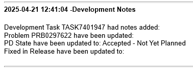

Because this is annoying:
Thanks for taking one for the team, @hmwillett
I’m hoping that submitting it under the controlled release will get more traction than standard. :crossed_fingers:
