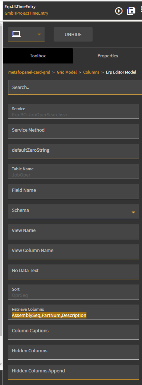

In 2024.2 there was a bug in Time Entry on the Weekly page where the Opr Seq did not display the Operation Details in the Combo such as OpCode & Description. The Grid Combo is a Reusable Combo and the issue is because the Retrieve Columns were incorrect (they look like they were copied from the JobAsm Combo next to it, see properties below).
We had to create a layer for this App in one of the companies for other changes, but now that we have upgraded to 2025.1 it looks like in the Base the combo has been corrected but in our custom layer the Retrieve Columns are still incorrect and I can’t find any way to correct it in the layer.
So either how can I correct my layer by being able to edit the Retrieve Columns or inherit the 2025.1 Base property?
