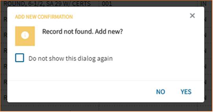

To summarize, we have a different part number “counter” for each Part Class. So the user has to first choose a Part Class, then click a button to get the next available Part Number for that Part Class. This all works… but we’ve had to jump through some hoops to block some system default functionality for adding parts. For example, if a user types a non-existing part number into the Part Search… the system prompts: “Record not found. Add new?”
In this way a user can create any “Part Number” they want… outside of our Part Numbering scheme.

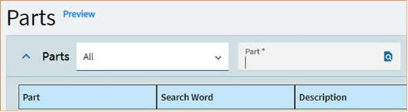

On the Part Entry Landing Page… we’ve set the Part Search field to read-only, search only. However, the problem I’m currently having is that when the page first loads, the cursor is placed inside that Part Search field by default. So, even though the Part Number field is read-only/search-only… when the page first loads, I can type in a non-existing part number and get the “Add new?” prompt:
Cursor appears in textbox on page load…

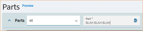

I’m able to type…

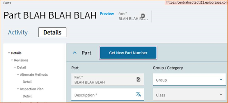

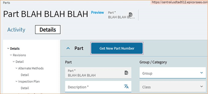

System allows me to save record!
Resulting part with bad part numbering…
If I click outside of that Part Search field on the Landing Page, I cannot click back in… so the read-only functionality works. But the problem is, it is “in focus” when the form initially loads.
Is there any way to automatically shift focus anywhere else when the Landing Page first opens?
Or… even better… is there any way to turn off the “Record not found. Add new?” functionality?
Are you using a Data Directive on Part? It doesn’t block the message but should block the new part creation.
