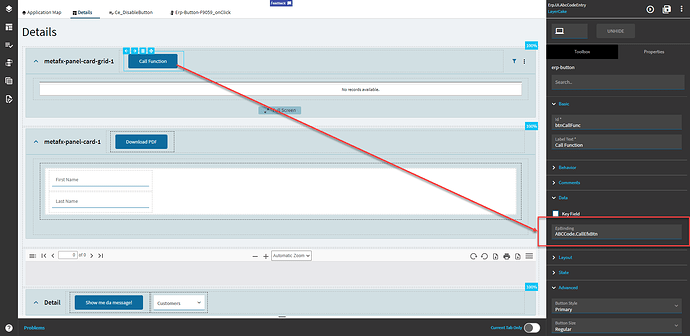

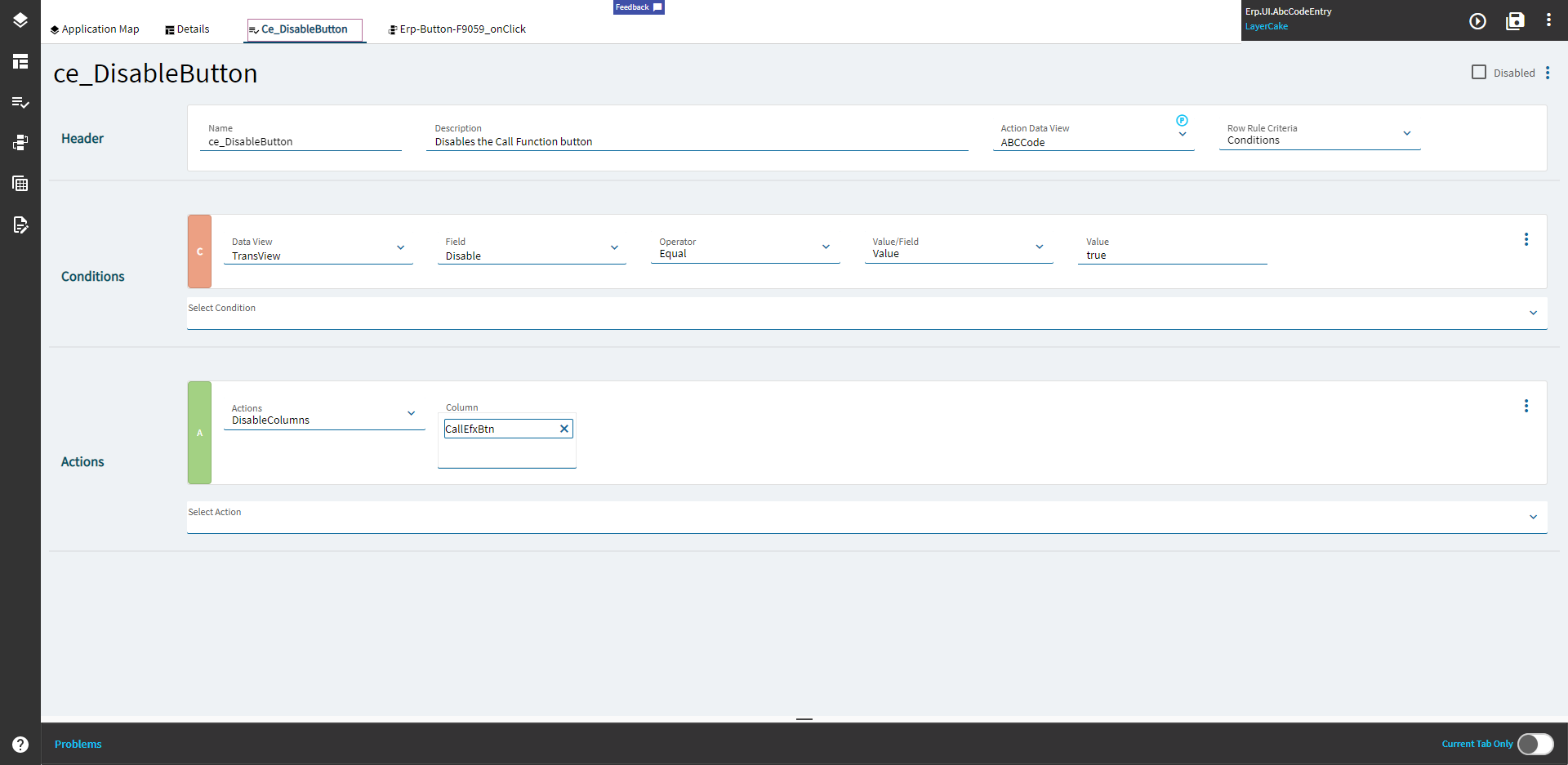

You’re going to want to do a combination of rules and events.
  1. Bind your button to a field (it doesn’t have to be real DB column)
  1. Add a row-update widget to your button click event that sets something like TransView.Disable to true. Add a second one after your function call that will set it back to false.
  1. Create a rule that checks the state of TransView.Disable and disable the column you bound your button to if true. This will auto reverse if false

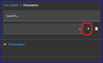

Hmm in my rowupdate I dont get a columns item under parameters. It is just a blank screen.
Ha you can just add a 1 for the view.
However the rules section will not let me select a column that does not exist for the data rule part or even just type it in.
Do I have to add the CallEFXButton column to the view? I can type it in by disable columns in the rule but it just disappears.
Clickty the (+)
Yeah the rules will not let me add the CallEfxBtn to the last text box in the rule.
I can type it in but it vanishes. Even if I cut and past it from the button binding.
So close. I set the binding and added the rowupdate widget and can setup the rule except for the very last piece…
At that point it wont let you save, it says there is an error.
Is it because it is a view based on a BAQ, do I need to actually add a CallEfxBtn column?

Update: Eventually after typing a few times and hovering it gave me a little + to add the CallEfxBtn to the rule. It doesnt do anything. And Application studio says there is an error but when I click that it wont say what the error is.
Clarification: It says there is an error from the minute I start creating the ruke before I enter anything.
I finally got it to work.
The binding had to be to a real column in the BAQ, after that there was no issue.
I just made a boolean column called Calculated_CallEfxButton - set the default value to false and bound the button to that and used that column for the rule.

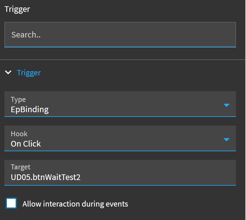

I’m pretty sure I saw an option that exists now to just disable events on it until it finishes.
