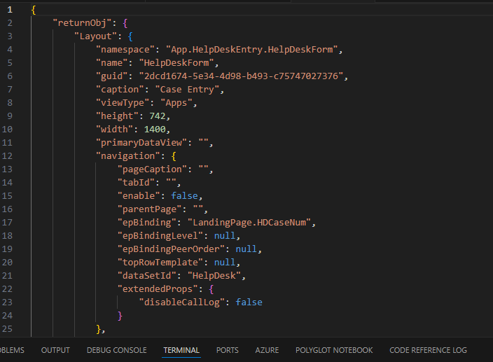

The data lives in XXXDef under Type: KNTCCustLayer or something along those lines…
It’s in JSON and Character01 or 03 can’t remember…

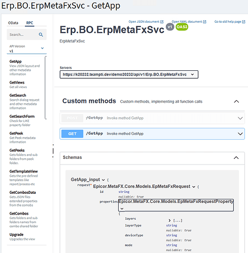

If you do a trace (Chrome Dev Tools), you’ll see a call to the Erp.BO.ErpMetaFxSvc.GetApp endpoint.
Look at the Payload and you’ll see how to call the routine.
The Response will hold the JSON file. You should be able to call it with Base and your Layer(s) and download those for a comparison.
