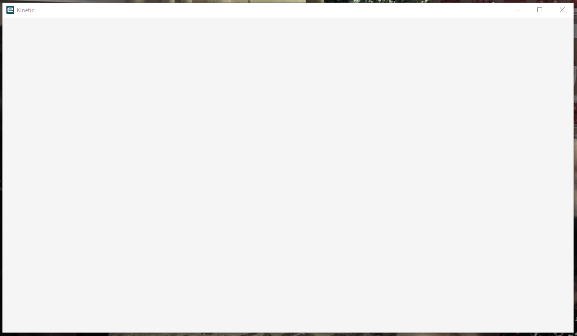

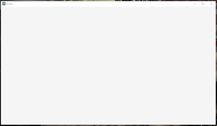

When one of our users attempts to log in to Epicor, they get a blank white screen that doesn’t load anything or produce an error message. It’s a consistent issue though where it happens every time they log in each morning and also if they were to log out during the day. Generally, it will let them log in on the 2nd try, but there are times where it takes several tries to get in (without them going in and ending the Epicor Session Manager task). Since we can almost always get them in, it’s not a super high priority, but it is definitely frustrating them and the support team has not given us a successful solution. Luckily it only happens to one person, but our worry is that it will spread to other users. We’ve tried reinstalling Epicor, deleting temp folders, and even a “deep clean” of the cache like support recommended, but every morning that user gets the white screen. Has anyone else successfully remedied this?

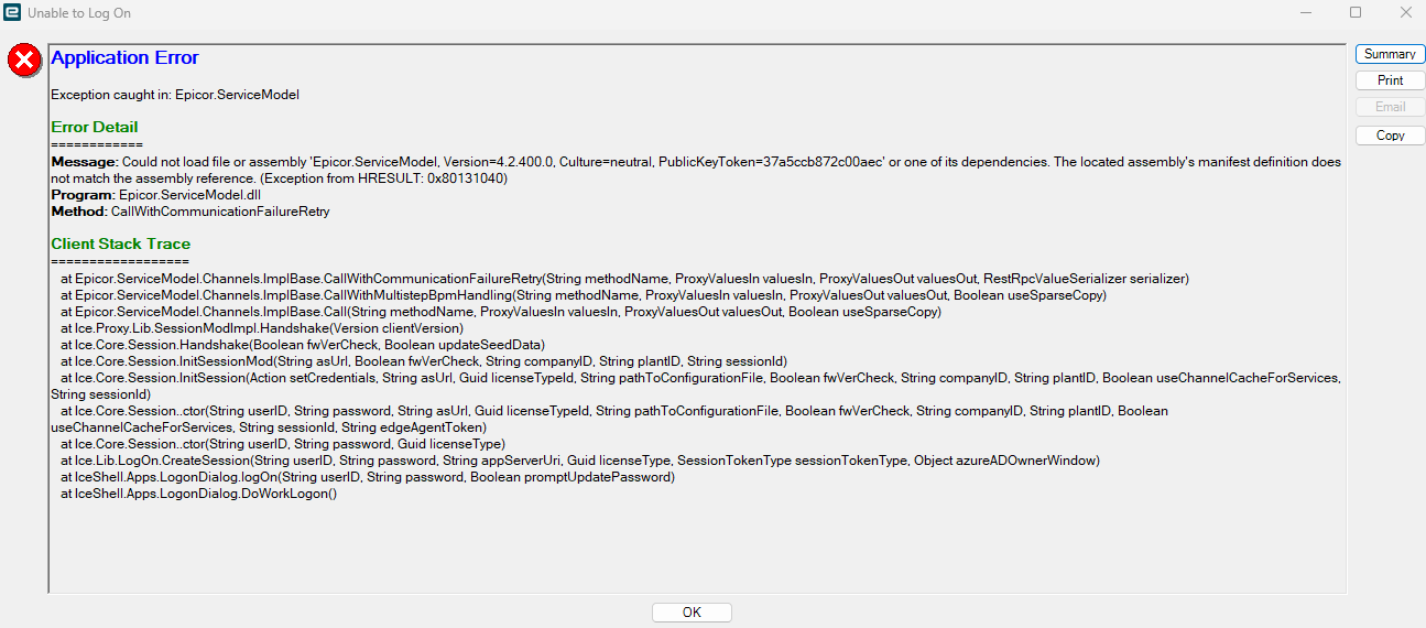

After following the instructions in that KB article and creating a copied shortcut with the altered config file, I was able to login once, but then when I went to retry it, it now throws an error after logging in and then takes me to the Epicor Status website where it shows me that the servers in Australia and Singapore are under maintenance. Any idea what this could be?
