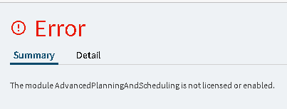

  1. When i try to start a new production item i get a licensing error saying i need advanced scheduling . . . I am able to start an operation (despite the message).

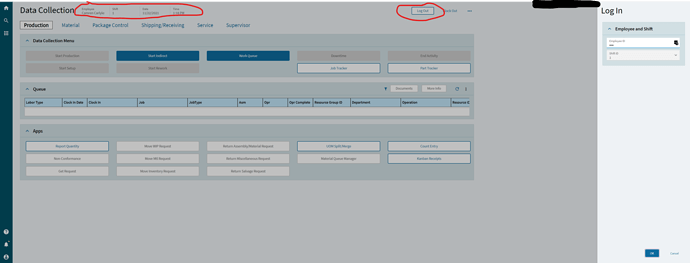

Try mode=DC instead.
MES is the old, DC (data collection ) is the new.
Mr. Aaron: Thank you for the suggestion. That helped remove the licensing error (advanced scheduling required . . .)
Still unable to login to two operations at the same time without deleting the first entry.
DaveO

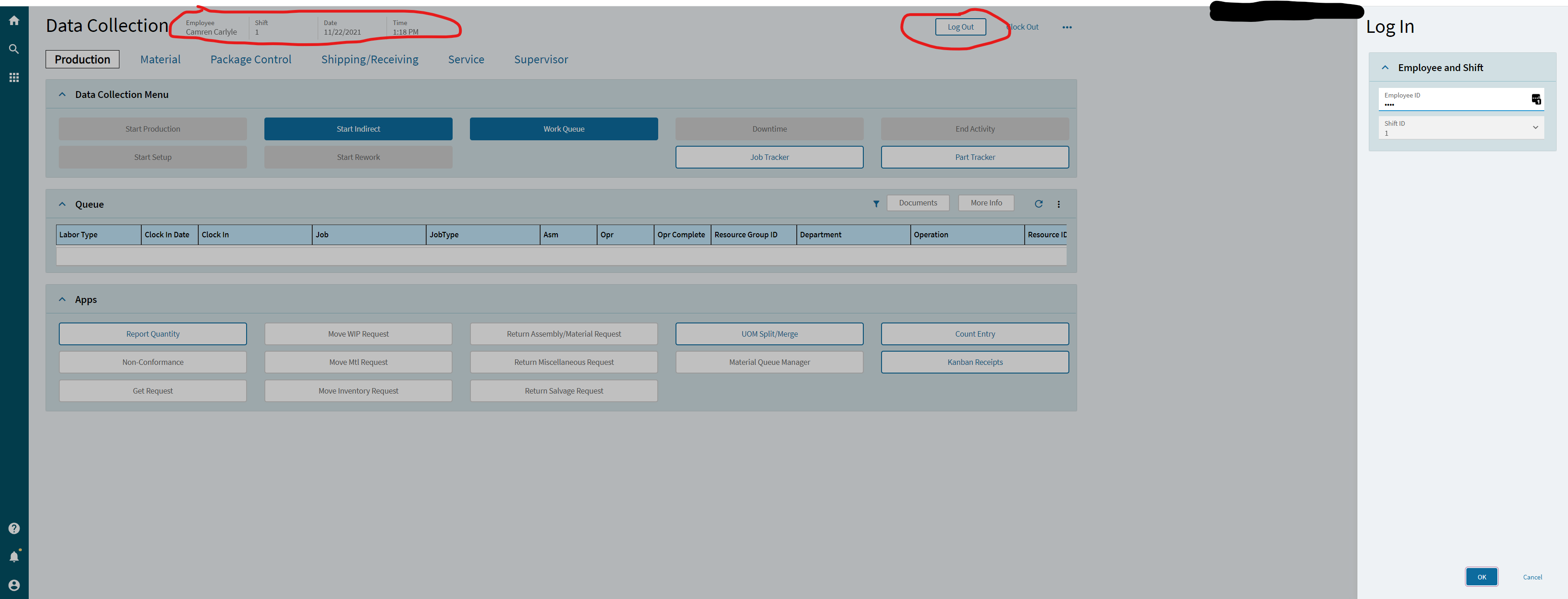

Oops - spoke too soon:
@DaveOlender … I’ve tried in our sandbox (on prem), we’re not getting that error. Maybe it has to do with the .2?
When I used his link, it redirected me to this mode. I remember in .700, the MES mode would result in a full license usage. This time only data collection.
EDIT: Actually I think the URL was already in my browser. I forced the MES and it stayed. Everything looked the same and it still only used the DC license.
Awesome. Maybe they depreciated the MES variation. I know they said they would.

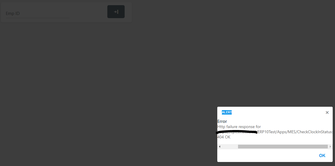

has anyone got ā€˜On prem’ MES URL working ? i have few trials and this is my error
Dave, I am currently testing the broswer MES on an Android tablet and having the same problem with the licensing error at random times. Curious if you had success with tablet / browser MES.

Hi @DaveOlender - I am getting the same licensing error in MES (using most current URL). We are on public cloud - don’t know if that matters. I have had a ticket in EpicCare since mid November. Very frustrating because I really want our users to start using the URL - so far it works reasonably well - but not with this annoying error message. If there are 5 operations open, you get 5 errors.
