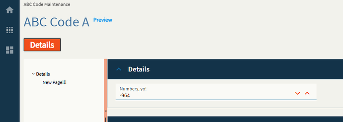

I made a discovery here.
Looks like you can enter negative numbers if the control is bound to an actual database field while TransView does not allow it.
