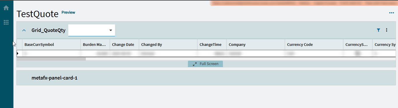

Have I forgot how to work or something changed after upgrades? I am creating dashboard (Ice.UIDbd.xxxx) and when I add window event OnLoad, it does nothing (Checked with erp message widget), previously created dashboards with this event works as expected anyone has this issue?

You have to add SOMETHING to your form. Just a blank Panel Card, or something. There needs to be something to load.
If the first thing you do is add the Window_onLoad event, nothing happens.
But if you add a blank panel card to the form, the Window_onLoad event will fire.

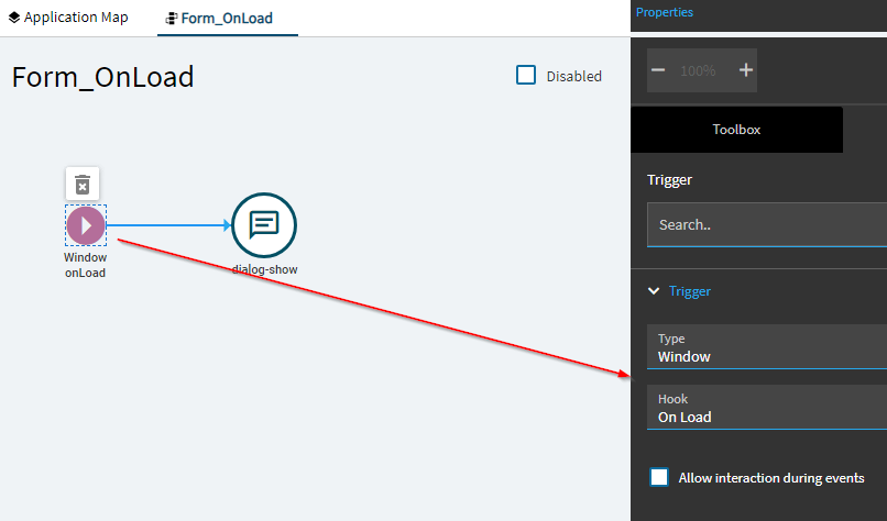

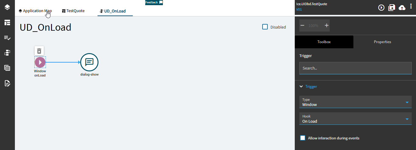

Sorry to revive this post, but i’ve got the exact same issue, and Window_OnLoad will not trigger in any way.
Version : 2025.1.11
Event :
The event is in a dashboard that loads data :
I’ve tested with other dashboards, and the event will not trigger in any of them.
Anyone having the same issue ?

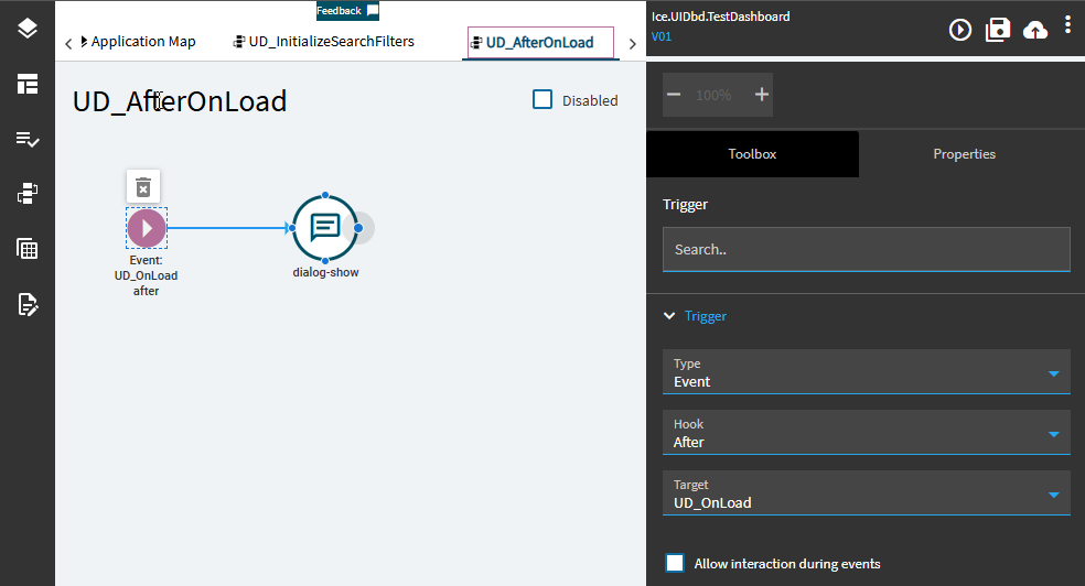

Have you tried @dcamlin’s suggestion of using an After_Window_onLoad trigger? You’ll still need the Window_onLoad event, just create a new ever where the trigger type is event and do after Window_onLoad. I usually won’t put anything in the Window_onLoad except initializing Transview.
Not working :

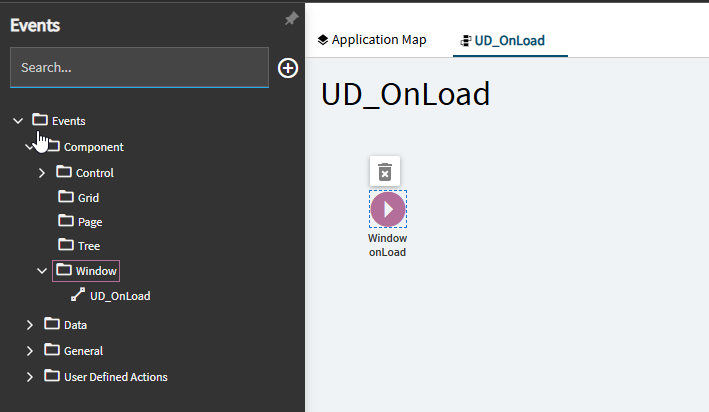

Can you verify you only have 1 event with the window onLoad trigger? They would show up on the event tree under Component>Window. Also did you try without the console-write widget? It shouldn’t cause a problem unless it just doesn’t like the syntax of what you’re trying to write. If you want to leave it in there I’d put this in the value to turn on the debug logging in the dev tools
#_epDebug.toggleDebugLogging()_#
I’ve got only one event under Window_OnLoad and I tried deleting the console widget, still nothing

Just saw the note about the version so I created a new dashboard from scratch in our Third environment that’s also on 25.1.11. Single panel card on the dashboard (zero setup) Window_Onload event, After_Window_onLoad event with a message widget and it worked fine.
It did have some odd behavior when I was creating the events, it wouldn’t let me name the event and set the trigger conditions in one go. I had to save after naming, close the event and then reopen to set the trigger, but when I previewed it the message popped up when the page loaded.

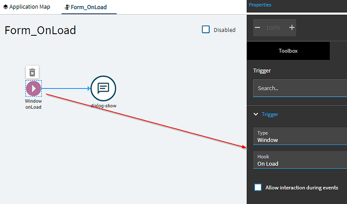

Sorry for resurrecting a “solved” solution, but it’s not solved for me. :slight_smile:
I’m working with an updatable dashboard, which the manual setup doesn’t seem to address.
So, when I create a new dashboard via the wizard, I’m not able to make the On Load work:
The dialog box never fires so I can set up a TransView dataview for filters.
I’m wondering what other event might be available to key from when the form fires.
