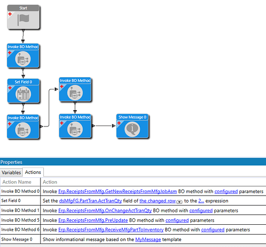

Kindly please advice the proper way of perform the ReciptFromMfg through UBaq, and my following sample that its does not return any error after fill the ds but the MFG-STK does not appear in my parttran, is there something I has missed?
after Method 6 where is your Update?.. Also are you passing RowMod = U
Hi @aarong thanks for your response, that’s mean i has missing on another BO Invoke for UpdateExt or? I did set the RowMod = U and then I remove it and found there’s no different where still not able to create me a row in PartTran.
I’m interested to know your advise what should I insert after Method 6.
Does “changed row” include “added” rows? Asking for a friend… lol
Yes… Changed row is Added & Updated rows
You need to update the dataset after your final call.
Did you follow a trace? A trace will let you know the steps you need to take.

hi @aarong , from the trace route as what I have as follow which try the simple UBaq
Erp.Proxy.BO.ReceiptsFromMfgImpl GetNewReceiptsFromMfgJobAsm
Set PartTrantablesets on Qty = 1
OnChangeActTranQty
PreUpdate
ReceiveMfgPartToInventory
I think i has miss out something and I do set the RowMod to U or A after change qty but still nothing happen in my PartTran, Sorry I has try on this simple UBaq just hope to get the update in my PartTran, some how I has able to create UBaq on Material Issue which without any error and successfully create the transaction in Epicor, just my bad I have confuse the terms of ReceiptsFromMfg how to get this work?
