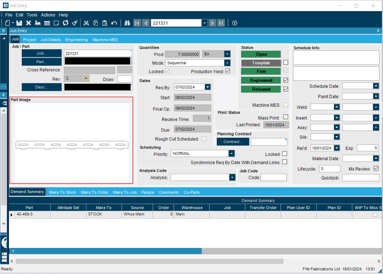

Using the Classic UI on version 2022.2.10 - I display a jpeg image of Parts:
Using a screen customisation:
  1. I define a path - string path = @"\\xxx\xxxxxxx\xxxxxxxxxx";
  2. I define a filename - string filename = view.dataView[args.Row]["PartNum"].ToString() + ".jpg";
  3. If the file exists, I then display the image.
Has anyone done similar in Kinetic or know how this might be achieved.
I know I will need to attach my code to something triggered through JobEntry.

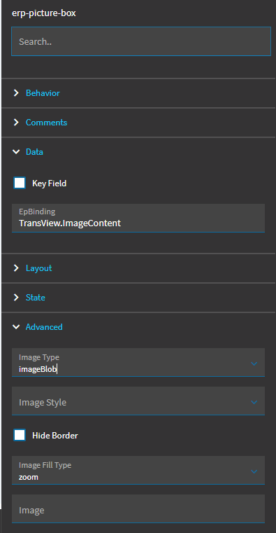

I have not played around with images within Epicor (yet)… but Kinetic App Studio has a Picture Box widget. Perhaps you can start here:
Create function to convert unc path into base64 string and store in TransView.ImageContent (adjust to the picturebox epbinding)

In my case, i am load picture form last attachment image from table. So, i used trigger event after aftergetbyid to call function.
Function used:
ImageHelper.efxb (15.9 KB)
