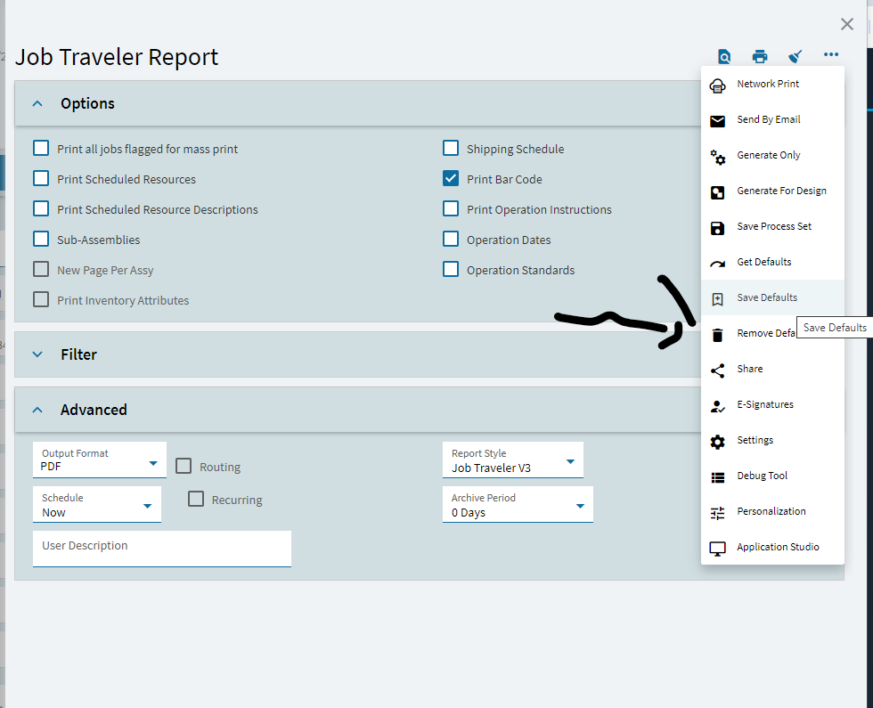

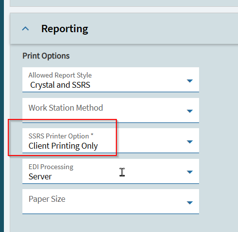

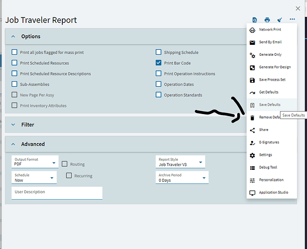

This option will fix it, if its feasible for your environment:

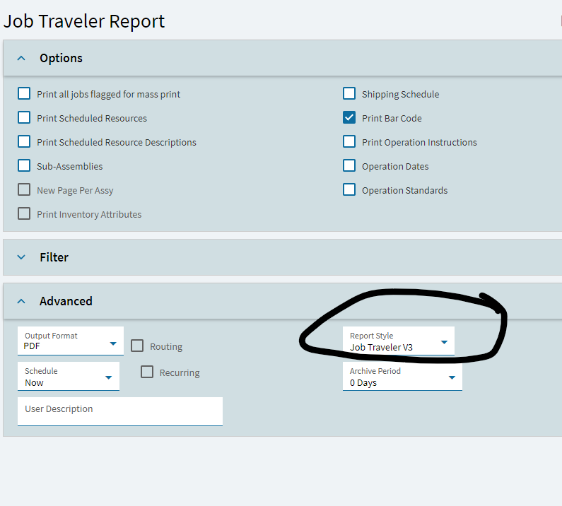

Try selecting the report style manually as well. We had a few folks that had a personaliztion and the report style for them was pointing to an invalid one, which caused the printer spinning.
Then make sure they don’t have a personalization on the print screen as well.
