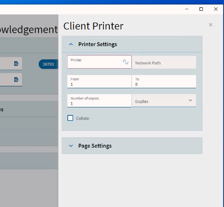

Kinetic Print Screen - Client Printer List spinning
Anyone ever have the client printer list just spin and spin and spin and never load up the available networked printers on a Kinetic print screen? This happens to random users, randomly. They will get into the office, go to print something from a Kinetic print screen and the client printer list will never display.
They cancel, do a print preview, then print from there, but this is frustrating to them.
Any ideas? We’ve reduced the networked printers on the workstation to a minimum and rebooted machines, still sometimes this issue just pops up again.

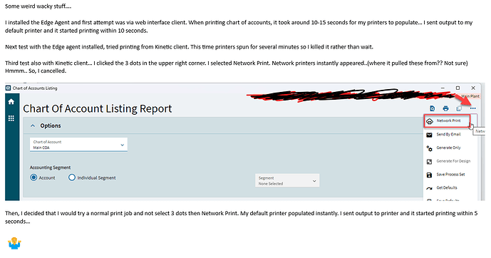

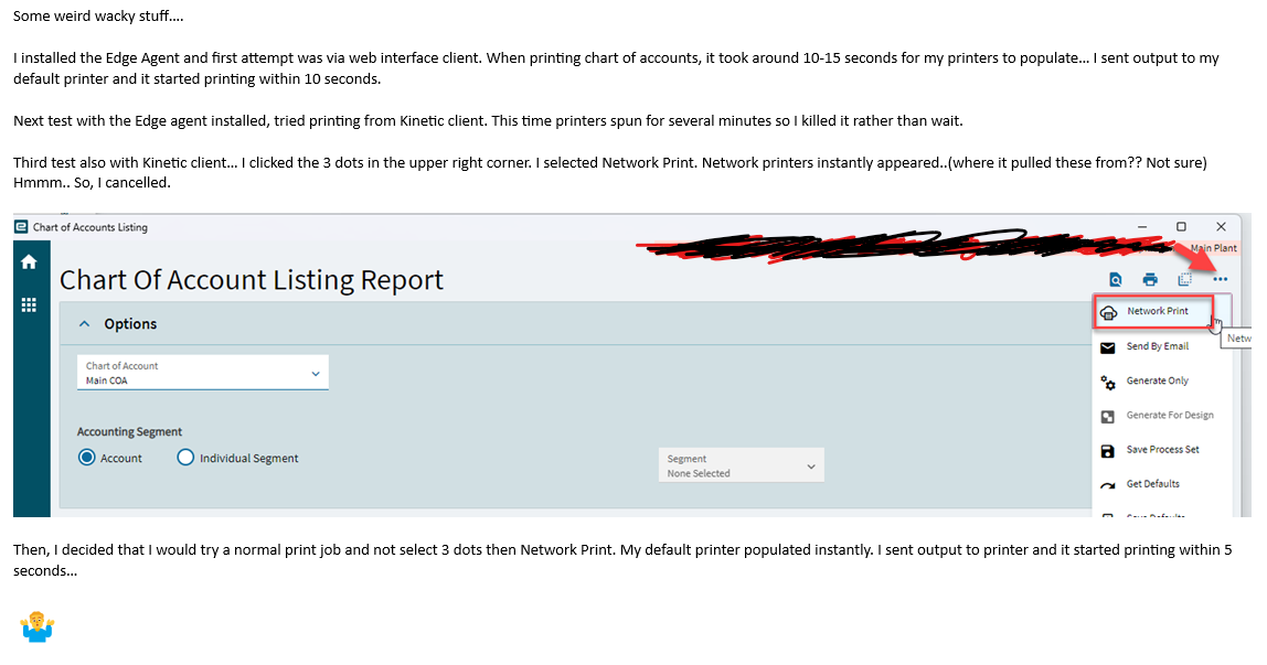

Here are some notes from my IT director who was also testing it out trying to get anything to work to stop the printing… He did find something odd that seemed to speed it up, but it was quite the dance…

If anyone who has spinning when loading printers could try the steps in this post and let us know if you get better results that would be cool.
Then we can tell Epicor there is something that kinda solves it and maybe they get closer to resolving the issue.
