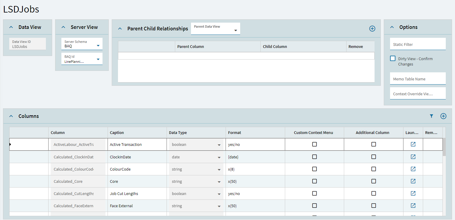

Are you using a dataview to store the BAQ response?
i have no idea how its doing this!
yes using a dataview

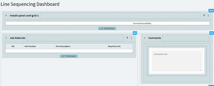

top metafxpanel filters the job materials one and the comments one.

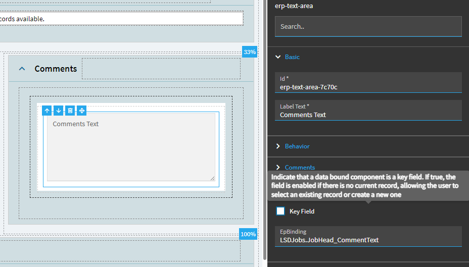

text area simply has the following:
there are no other settings on this at all which make the comments appear, and they do appear no problem at all - and its correct

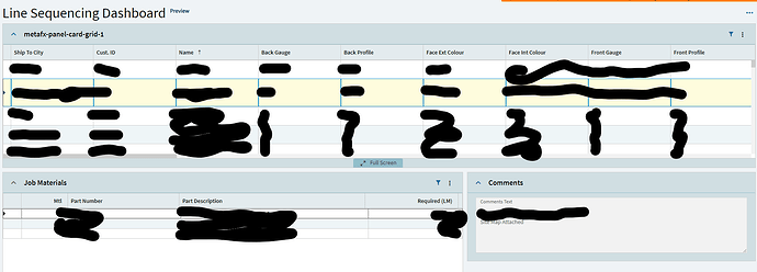

and running the dashboard comments appear
i have been through EVERY setting relating to the panel cards, the text area etc, basically every component relating to those two areas and there is nothing that says when this changes do this sort of speak…nothing like a where list because there is not anywhere to do such a thing
