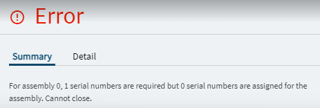

We have a frequent issue with our job closing process that results in the lovely error we see oh so often:
This presumably happens because we need to manually modify the Serial Numbers since we’re frequently reworking the same numbers into different part numbers / statuses. There usually are no numbers to assign in Serial Number Assignment, or if there are - it does not accurately reflect in that error message either.

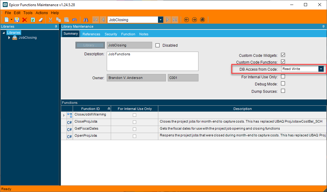

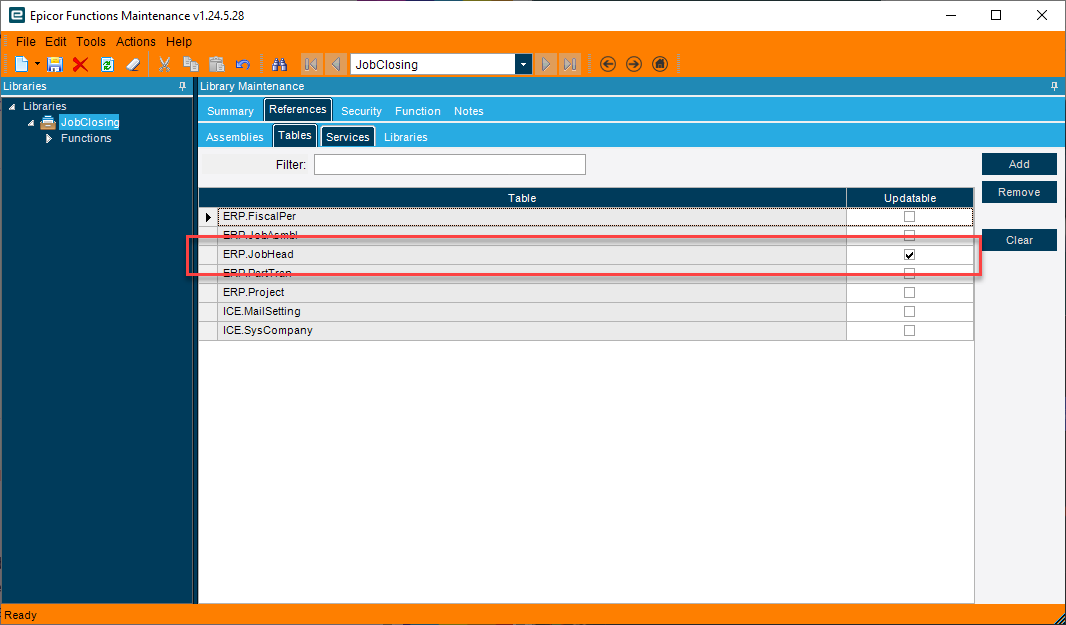

Oh yeah, super doable.
You would have to enable Read/Write and updateable on the table.
Then you should be able to directly update the record without using the BO (which is a good use-case in this instance, otherwise I would advocate for using the BO).
I have a meeting to be at in a minute, but can help you write out the C# after if you need help with that. (Or someone else can if they happen to see this)

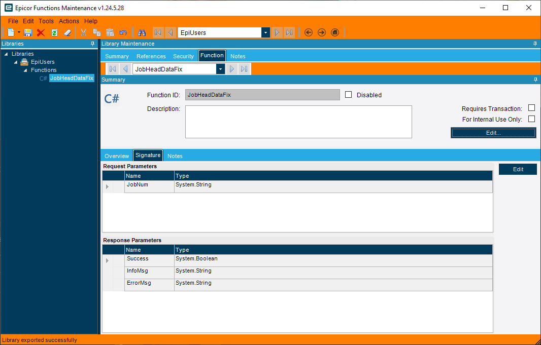

Here ya go: EpiUsers.efxb (2.0 KB)
Give it a job–it closes ze job.
try
  var jobRecord = (
    from jh in Db.JobHead
    where jh.Company == Session.CompanyID &&
          jh.JobNum == this.JobNum
    select jh).FirstOrDefault();
  if( jobRecord != null )
    jobRecord.ClosedDate = DateTime.Today;
    jobRecord.JobCompletionDate = DateTime.Today;
    jobRecord.JobClosed = true;
    jobRecord.JobComplete = true;
    Db.SaveChanges();
  Success = true;
catch(Exception e)
  ErrorMsg = e.Message.ToString();
  Success = false;

    When we try to close the job, we get met with that serial number assignment error. If we use Serial Number Assignment, it gives us no SNs to pull (and we need not create any).
