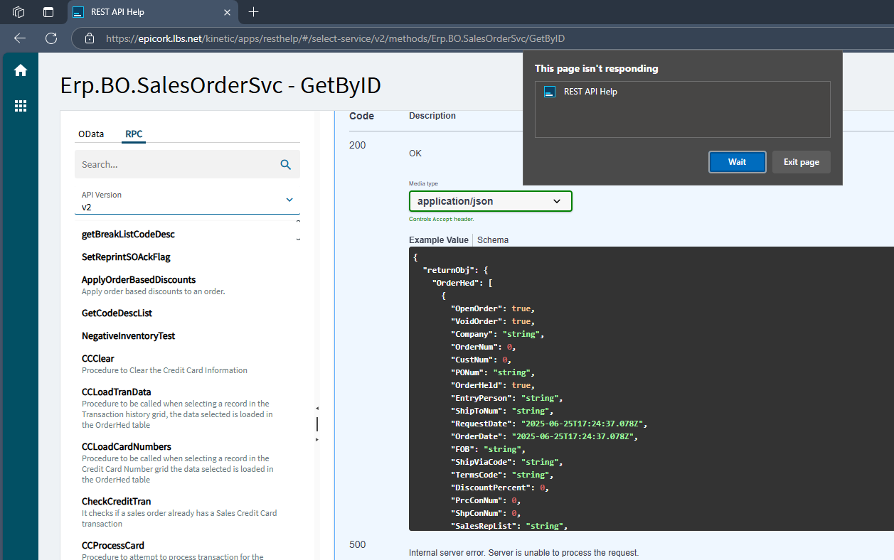

Why? I thought the idea behind the OData routes was that you have great flexibility between $select, $filter, and $expand to specify which data you want, how it’s presented, and even to pull child information. Except the reality I am running into here is that a simple, straightforward query - what would be a 1 line SELECT in a SQL context - requires multiple classes to operate through REST and gets you either no data or, in the case of using $expand, creates an unacceptable processing bottleneck (pulling just the OrderDtls along with the Order header for even a moderately sized order of ~100 sales order lines effectively crashes the call. I waited over five minutes and gave up - no user will - or should! - tolerate that.)

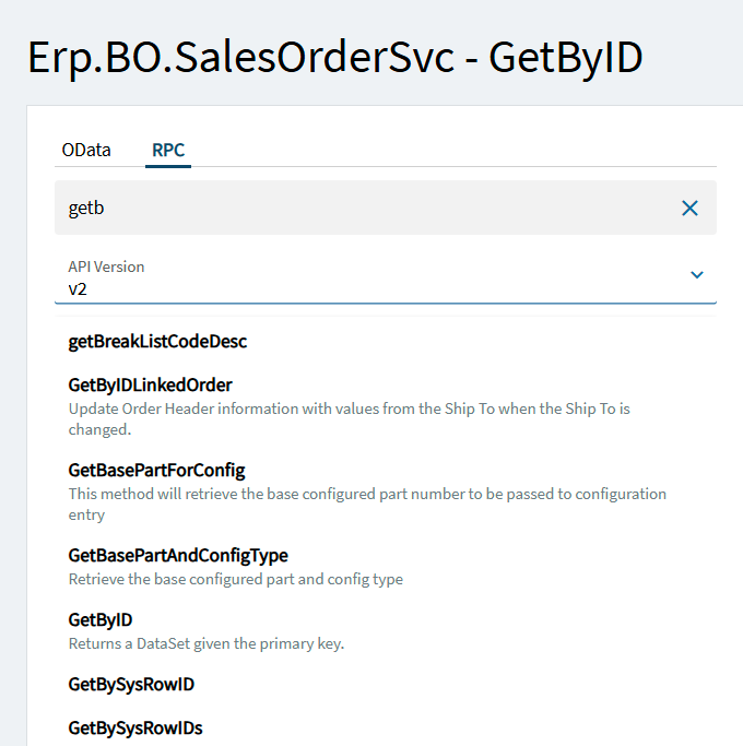

The GetById route gets me the SalesOrder, but I still need the child objects - this route does not retrieve those keys, so I need a second call to get the OrderLine numbers, then one GetById call apiece for each OrderLine. Same process for the releases for each OrderLine.
That route returns the whole shebang.

Try the regular swagger page if that one is too intense.
https://yourserveraddress/server/api/help/v2/
Edit: Or open something with less data lol, I’ve seen people with 10000 line sales orders.

Pull it in postman.

This SalesOrder only has about 100 lines, so unless I am vastly misunderstanding the volume of data involved I feel like it should at least open before the Edge mercy message comes up.

I have had both great, and crap performance from those pages. YMMV.
Just don’t judge the API performance from them. Do it in code or postman for a better test.

Epicor’s helper page has issues with big datasets so use the Swagger version or Postman like @klincecum mentioned.
