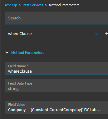

Kinetic rest-erp where clause syntax question
Hmmm, let me try it too since I’m a version behind at 2023.1.4
Works for me in 2021.2.10.
I’m using 2023.1.6 (my test environment) (updated profile)
I really hope they didn’t break it then. So far it worked for me with a constant. Let me see if setting something on a normal (non TransView) view works
Doubtful. I’ve successfully done it in both 2021.2.10 and 2023.1.6 using both TransView and OrderDtl per Scott’s scenario.

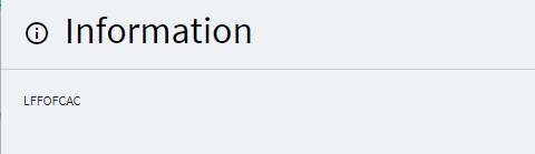

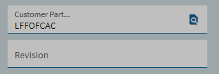

@datadaddy for debugging’s sake–if, in your onBlur event, you just put a message widget with {OrderDtl.XPartNum} as the message, does it show undefined or the XPartNum?
Works for me too. If it was me, I would hope it was just one of those glitches from having the editor open too long. Close it all, launch a fresh Application Studio and try again. That has gotten me too many times. And when that works, it’s a different kind of frustration since you can’t replicate it.
Yep…
Order Detail screen…
Message handler…
