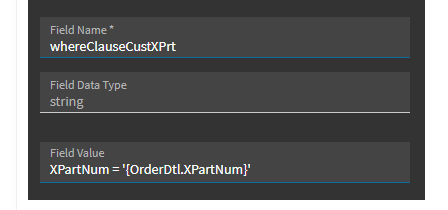

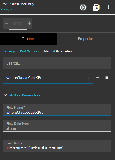

I have an event for checking if an XPartNum (Customer part number in Order Detail) exists.
The event is using rest-erp component calling CustXPrtSvc.GetRows like this:
I’ve tried every variation I can think of on the where clause syntax but it’s either return me records because the payload is showing an empty where clause or I get a correlation id error because the where clause syntax is invalid.

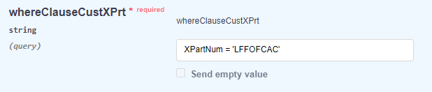

With the rest helper api, it executes just fine with:

Yes.
It doesn’t like replacing between the single quotes.
You’ll need an intermediary of some sort.
In a row-update:
I assigned CallContextBpmData.ShortChar01 to "'DP169X08CLCF'"
and in the erp-rest set it to XPartNum={CallContextBpmData.ShortChar01} and that worked.
Just got to figure out how to build the string with the single quotes and the field correctly :thinking:
Ok, you should be able to build a field with row-update and stick it in transview or call context
Expression for row update on CallContextBpmData.Shortchar01
"'" + "{OrderDtl.XPartNum}" + "'"

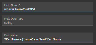

@klincecum
Thanks Kevin…I would have taken a very long time to try that out, gotta love that Application Studio tool :grimacing:
I did end up just using a TransView field and that worked just fine
THANK YOU !!!

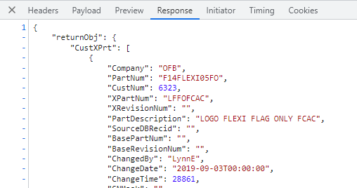

This is what my response looks like:

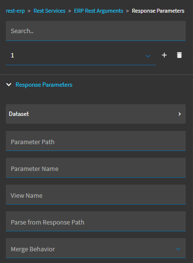

How do I check if my response has at least one CustXPrt row in my rest-erp response parameters, this stuff
I don’t have a CustXPart dataview or dataset,
can I use “Parse from Response Path” to look for say “returnObj.CustXPrt.XPartNum” for example ?
thanks again
You’d think :dumpster_fire: :rofl: , but I have no idea. :thinking:
maybe @hmwillett can come to the rescue (again) :pray: :roll_eyes:

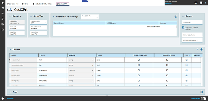

Add your own dataview and assign it to that.
You can use MyDv.MyColumn wherever you want.
Why not? Make one.
This is probably better than checking a field:
%cdv_CustXPrt.hasRow%

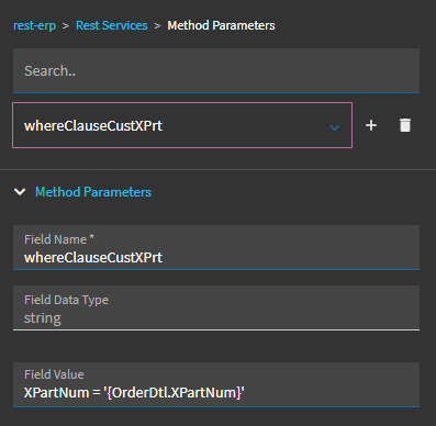

The where clause thing is very strange
This did not work (where clause showed up empty in payload)
but this did (@klincecum 's trick)
(I put the quotes directly in the TransView field in the database)
Thanks for the help on the latter part !

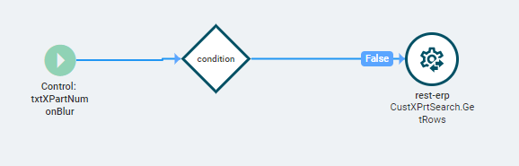

OrderRestCall

btw…
I did get everything working with %AA_OFB_CustXPrt.hasRow% for the condition
but for some reason {AA_OFB_CustXPrt} != undefined gives me an error saying the AA_OFB_CustXPart IS undefined (even though a valid record was returned)
