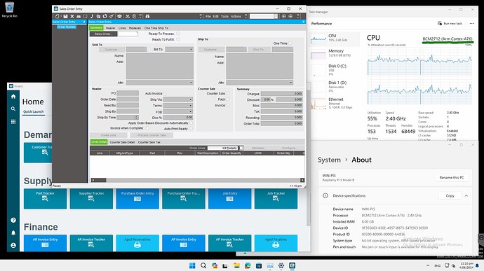

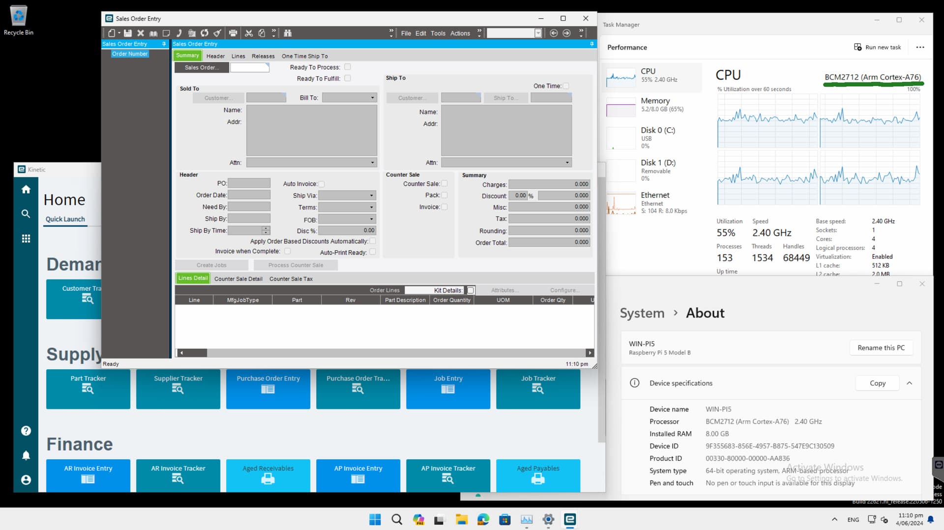

Got it running on a Pi4 4gb over the weekend but it was so slow it was basically unusable so ordered a Pi5 8gb and tried it on that. There were some issues, I got a M.2 hat for the Pi but windows will not recognise the NVME drive (worked perfectly in RPIos) so i had to use a USB to NVME enclosure i had. There are also no drivers for the Wifi or ethernet port built into the Pi5 (there is ethernet support on the Pi4) but a generic usb to ethernet dongle worked just fine.

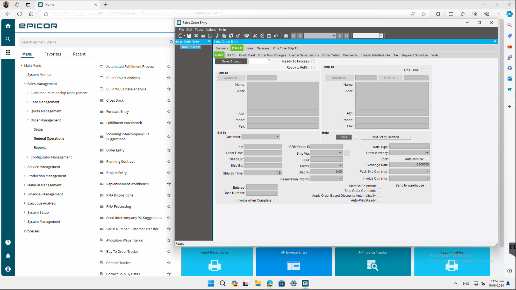

So after getting all that figured out i had a working windows 11 on ARM test setup running on a Pi5 and proceeded to configure it and install our Kinetic Client. And it works.

Yeah they eneded official support with the Pi4 but you can do it on the Pi5 by first installing Raspberry Pi OS and then installing PiAPPs.
In there is the Windows Flasher tool, you grab that and plug in a big enough USB hdd and the tool will grab and install the Pi5 UEFI and the windows oficial ARM image and setup a PE installation environment on the USB hdd, you then change the pi to boot from USB/NVME and reboot and it will boot into their custom windows installer and install windows on the Pi. Its was a fun little project.
I would not call it a daily usable windows install, its slow and clunky, but for the purpose i set it up, ‘can we run kinetic on these new ARM based laptops?’ It did the job and was a LOT cheaper than buying one of the laptops only to find out it doesn’t work :joy:

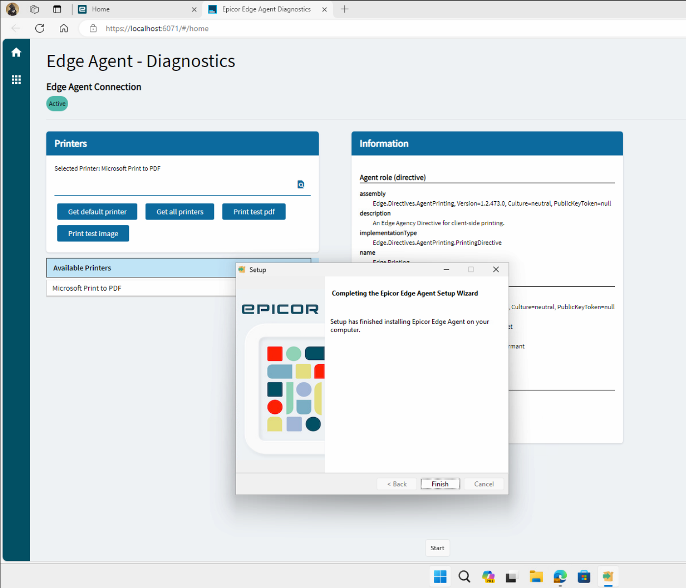

Edge Agent installation going ok so far, need to install a printer so I can test further.
