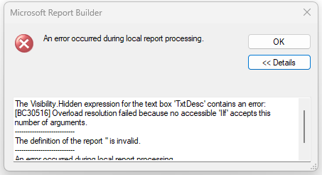

It doesn’t sound like the file structure of your upload is an issue, because otherwise, you’d be getting an ‘Could not find a part of the path’ error and not an error that simply says ‘Undefined’. It sounds like your main rdl file has an error. To Jeffs point, the classic screen is more helpful and will not just give you an undefined error, it would actually tell you where the issue in your RDL file is. However, instead of reverting to classic, you could always open your RDL file and run it. If when attempting to run, the only error you receive is “Object reference not set to an instance of an object.”, then your file is good and doesn’t have any issues. Otherwise, it will tell you where your issue is.
Report with no issues:
Report with bad visibility statement on textbox:
