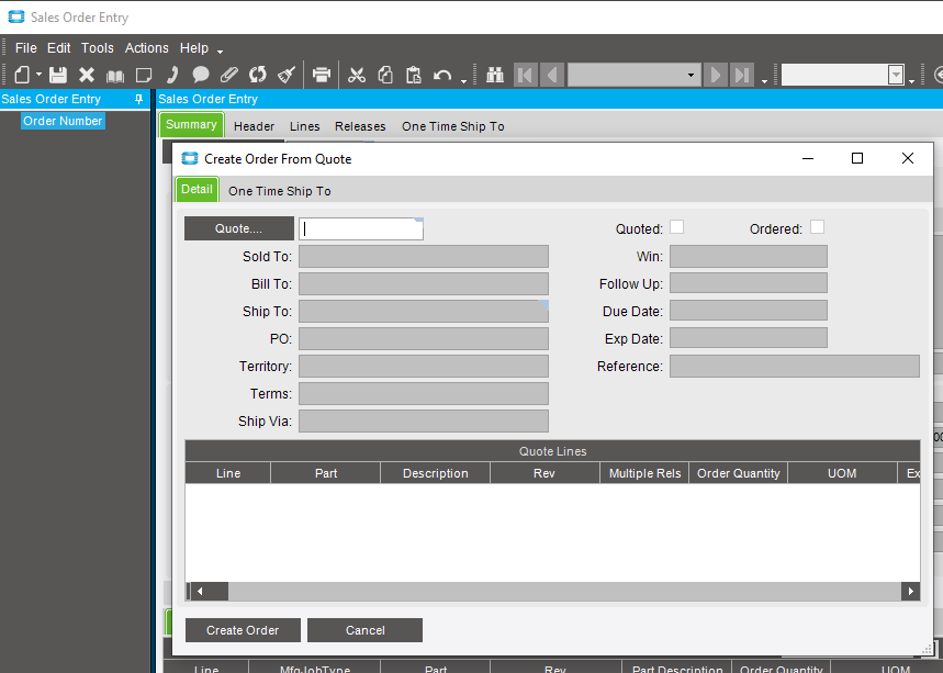

However, when trying to determine what Service Method to attach the method directive, we discovered that the Kinetic UI and Class UI utilize different service methods when clicking “Create” in the “Quote Order Wizard.” Can anyone confirm whether or not this type of situation is prevalent throughout the application? Recently, we reached out to Epicor about developing a customization for us, and the consultant assigned let me know that for the time being (while Classic and Kinetic forms are still available), they plan to continue using BPM directives almost exclusively to implement custom application logic so that the logic is applied across both UIs. But what’s the point of that if they use different service methods to accomplish the same task? I then have to create multiple directives. This also feeds into a bigger question that I have…

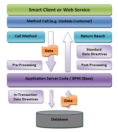

As Jonathan mentioned, if the trace changes (to improve performance in this case), then there’s going to be some reconciliation to do. And it really depends on the nature of the directive. I can’t think of a case where a data directive is affected by the UI change without a wholesale change of the business object - which could happen but is rare.
The ICE User Guide describes the various directives and you see that the UI is abstracted away. But you’re correct, if Epicor changes the trace between the UIs, maybe that should be disclosed as a breaking change. :person_shrugging:
The Kinetic UI calls CreateOrderFromQuote while the Classic UI calls CreateOrder.
It seems this was needed because with kinetic we try to move as much stuff as possible from the UI to the Backend, and it seems this is what happened here.
But I can see that internally CreateOrderFromQuote calls CreateOrder, so any bpms should trigger in both Classic/New UX, it just has some additional preprocessing which I guess it was either done on the classic client, or required additional server calls before CreateOrder was called.
I’m pretty sure that both Classic and Kinetic can each call CreateOrderFromQuote and CreateOrder depending on the menu item (Actions | Get Opportunity/Quote). And like Jonathon says, both will end up calling CreateOrder.
Thanks for the responses. Jonathan, you were correct. The directive was created on CreateOrder and triggered in both UIs.
