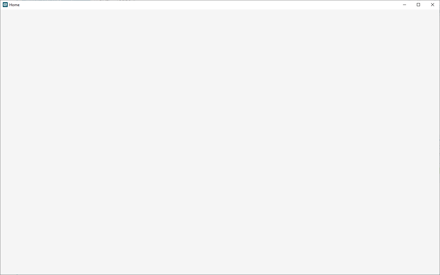

Kinetic UI - White Screen upon opening process
The white screen when you open a process happens fairly frequently to users on the Kinetic interface.
Has anyone found what is causing it?
Epicor support has stated, The main hurdle is that no one is able to reproduce it on command. Unless that can be done, it will be very difficult for development, support, etc to be able to get any necessary information that would be required to help identify the cause.
The only solution is to close the screen and reopen it.
