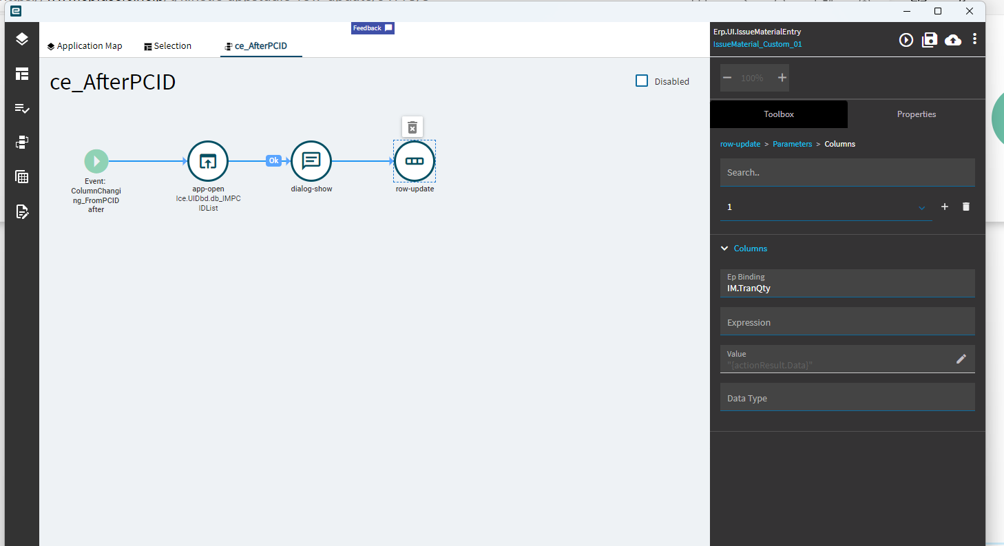

I have an issue to update TranQty in Issue material screen.
based on Hannah’s idea, i am able to get the value from the launch form and send value back to Issue material screen.
now, i tried to update actionResult.data to IM.TranQty but i got screen freeze.
but if i put actionResult.data to TransView.Data, it works and i created a numeric box and binding to TransView.Data and it displayed the value. I don’t know why IM.TranQty is not working.
also, i tried data rule to use TransView.Data to set value to IM.TranQty, same result, screen freeze. but in the data rule, if i hardcode value to IM.TranQty, it worked.
any suggestions?
