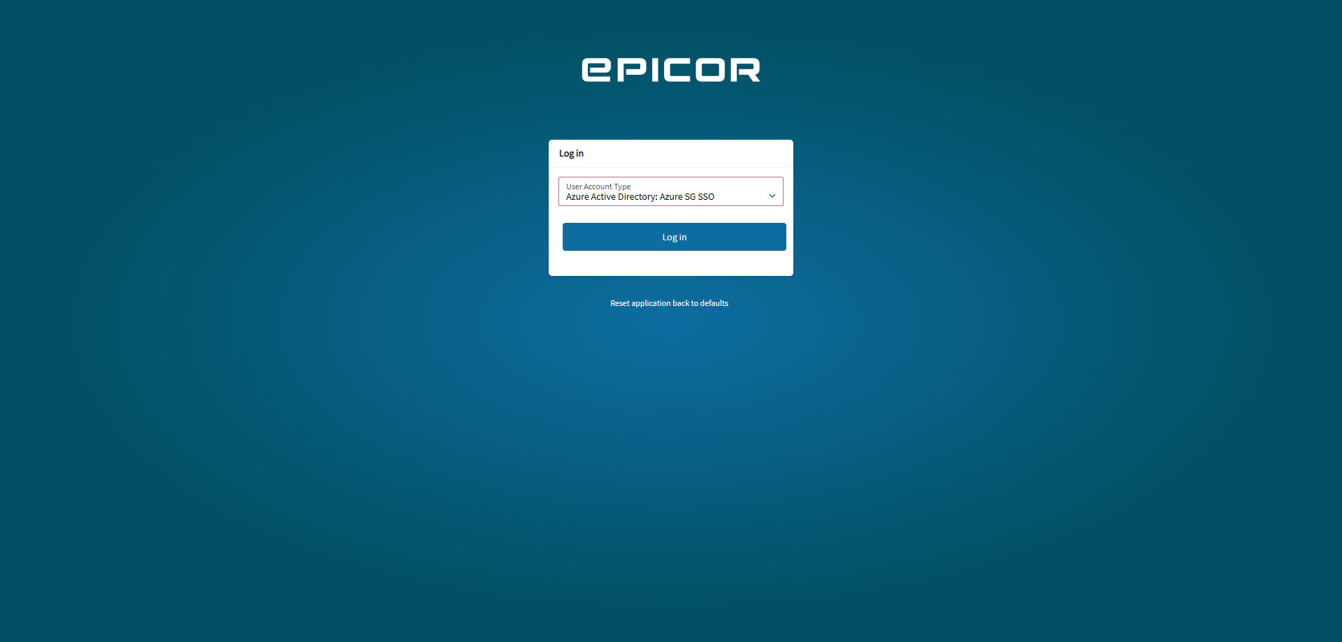

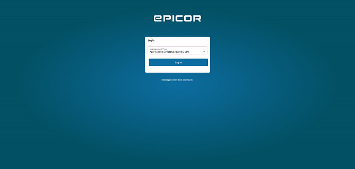

You could do single sign on.
Create a generic user account in Epicor with the same info that you log into Windows with and set the sysconfig to be SSO.
We use Azure AD for ours. They’ll be presented with a button to click, but they don’t have to type anything in.
