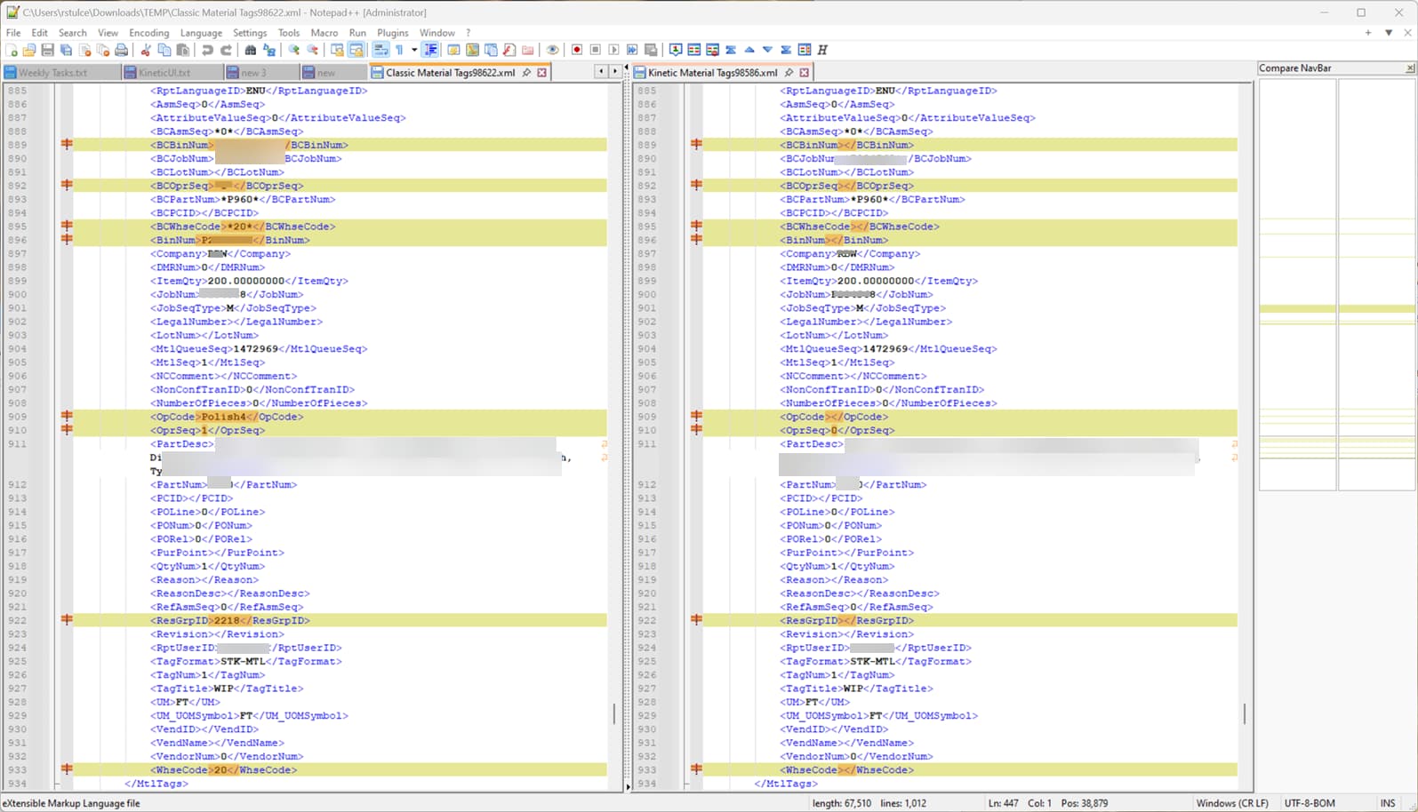

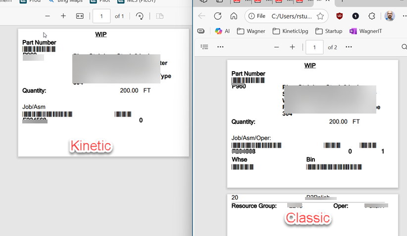

We went from Classic to KineticUI this Monday and our users reported that the mtltags aren’t printing the same. Investigation found that Kinetic is not exporting all the data to SSRS. Anyone else run into this? If so did you find a solution? I have contacted Support.
No other version/RDD/RDL/etc changes at the same time? This is the first I have heard/seen the same report with the same supposed data print differently.
Both printed with same JOB#, RDL, RDD, etc so they should print exactly the same.
