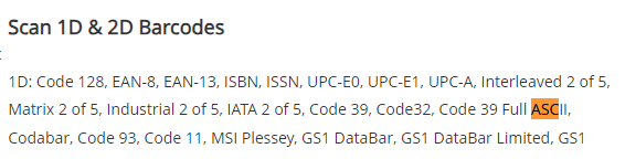

Possibly, the difference could be wether the scanners supports full ASCII?
The model I am using does support full ascii. I believe I have it enabled, I just have a booklet of mini barcodes to scan to configure the device and I scanned the enable for that one. Not a bad thought though.
