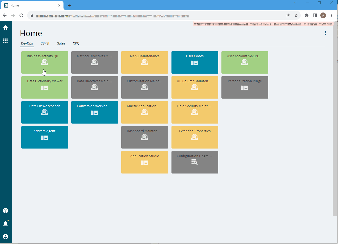

There’s got to be a simple setting I’m missing - How can I default the Kinetic homepage in my browser (Chrome) to open new tabs, rather than loading in the existing tab?
What’s weird is that if I click on my BAQ homepage shortcut, it opens a new tab. Yet when I click on UD Column Maintenance, the existing (homepage) tab re-loads as UD Columns maintenance.
If I hold shift when I click, BAQ opens in a new window, while UD Columns re-loads (replaces) the homepage.

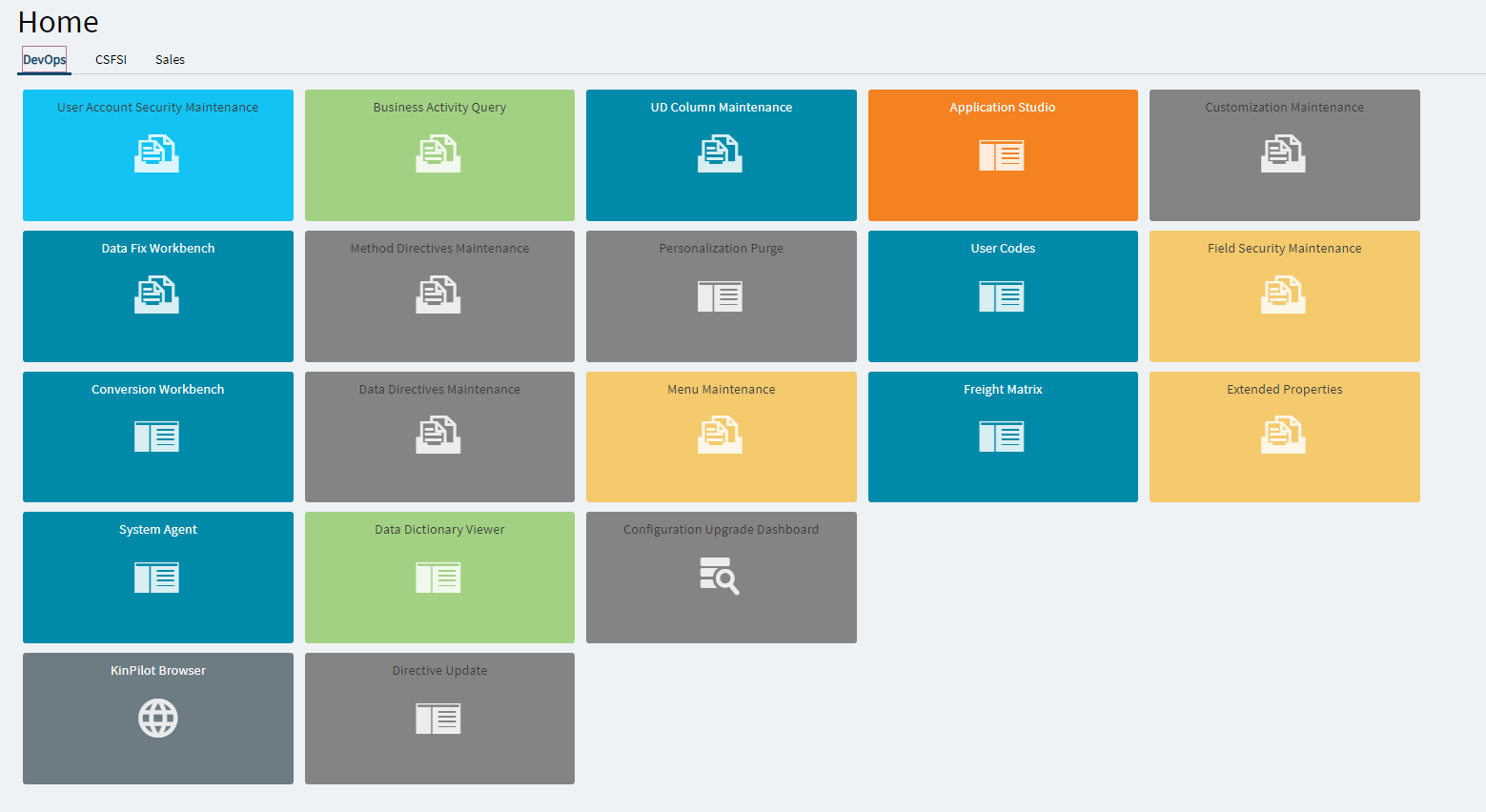

I just tried in the 2023.2.4 using the web browser Kinetic UI. Went to the Kinetic Homepage, then drilled down to Job Tracker and clicked it. It overwrote the homepage, rather than opening in a new tab :frowning:
KineticHomepage
For the side menu you can use ctrl + click to open in a new tab. (Or right click on the menu item and do open in a new tab. I don’t think the big blocks on the main menu work with this.

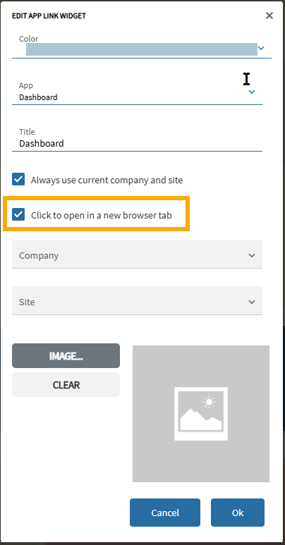

Edit the home page, then edit your home page widgets and click the “Click to Open in New Browser Tab”. You still need to Right Click>“Open in New Tab” from the side menu.
