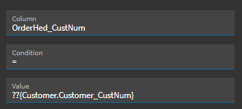

Oh…progress…I used this for my where clause on the 2nd grid:
(“Customer” is the actual name of my parent dataview I created)
interestingly, the behavior I get now is it first loads just the orders from the initially selected customer
(top one in the list of the first grid)
but then after about 5 seconds, the child grid refreshes and loads orders for all customers listed
but yet if I select another customer from the top grid, it loads only that customers orders, and stays that way, i.e. it works fine after the first customr
what the heck ?
Picture of the result (after selecting a customer after initial load)
I think I’m going to open a ticket with Epicor at this point, seems too strange
Thanks for the tweak on the where clause @dcamlin, yours wasn’t quite correct (like mine) but it got me to look closer at it :wink:
Change it to a single ‘?’.

Omg, that was it…
funny I had tried every combination of the ? thing but of course that was before I fixed my where clause,
then I didn’t bother to try both
Whoooo hoooo
