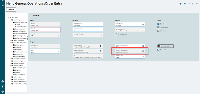

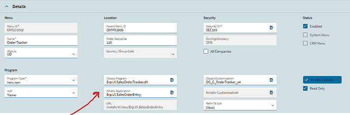

Looking at the Tracker Menu item in Menu Mainenance it looks like this:
Notice the Kinetic Application says “Erp.UI.SalesOrderEntry”
and if I search to try to change it there is no “Erp.UI.SalesOrderTracker”
but I have no Kinetic Customization specified
So when I launch Order Tracker, indeed I see a very limited version of Order Entry…makes sense so far

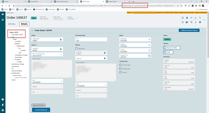

Even without the Kinetic customization specified if I go into Application Studio it takes me to the customization I have specified for Order Entry…and it no longer functions as a Tracker
So how do I make a layer and customize it for a Tracker then ?
Even if I select the Base layer in Application Studio or specify it as the Kinetic Customization in Menu Maintenance I still get Entry (not Tracker) type behavior

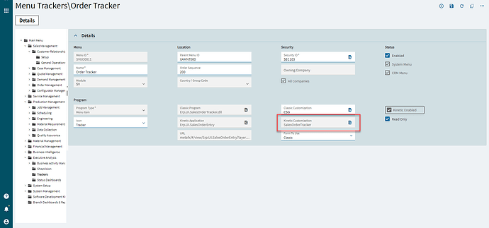

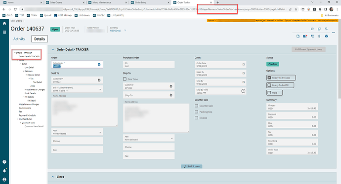

I placed a layer on my tracker menu, (saved, logout, exited after 2nd try :wink: )
And when I launch the Tracker I see what appears to be the base tracker
(no customizations and yes, everything is readonly),
but yet, when I then launch application studio, it shows the selected layer as active,
and when I Preview it, everything is writable, so I don’t have a tracker but a strange mix

I believe you, cuz that’s how it should work and your images clearly show it,
Do you ever get it when you put a layer on the menu and it just doesn’t take effect ?
It’s still bringing up tracker base not my layer (and the layer name is not in the address)
