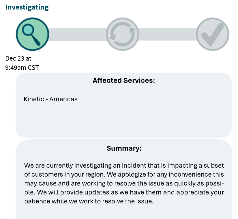

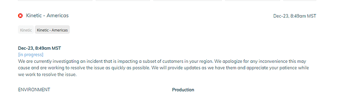

Hm status.epicor.com shows all green wish that was more accurate
