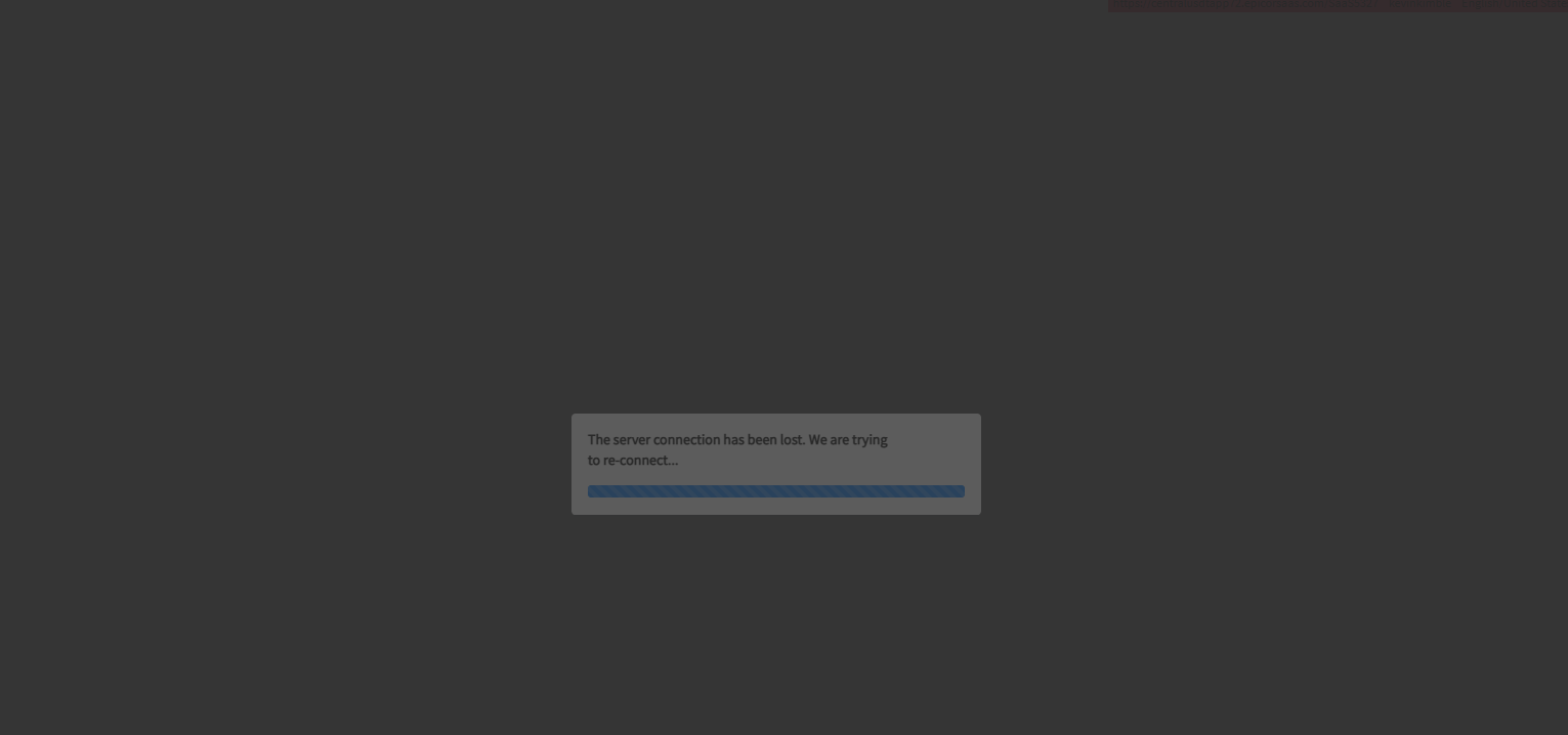

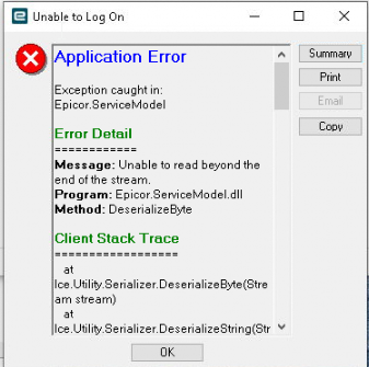

Unfortunately the bug is not fixed, either that or a new problem has been introduced. It is now impossibly slow to log in (3+ minutes) and often fails completely:

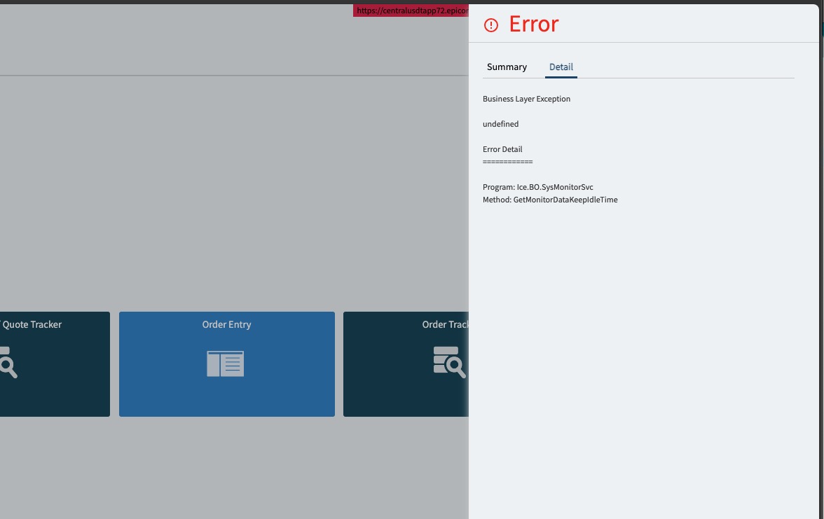

More errors after logging in:
This seems like a completely different issue although maybe trying to deserialize some of those XML files is causing the error.
If you blow away those files (all of those files) does it go away? Does it happen to everyone

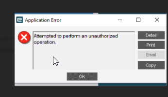

This is after deleting every scap of epicor from the pc and doing a clean reinstall.
System Information
AppServer Connection:
Form Name: ShellMenuForm
Customization Name:
Menu ID:
Software Version: 4.3.200.0
Application Error
Error Detail
##!Message:##! Attempted to perform an unauthorized operation.
##!Program:##! Epicor.ServiceModel.dll
##!Method:##! CallWithCommunicationFailureRetry
Client Stack Trace
at Epicor.ServiceModel.Channels.ImplBase.CallWithCommunicationFailureRetry(String methodName, ProxyValuesIn valuesIn, ProxyValuesOut valuesOut, RestRpcValueSerializer serializer)
at Epicor.ServiceModel.Channels.ImplBase.CallWithMultistepBpmHandling(String methodName, ProxyValuesIn valuesIn, ProxyValuesOut valuesOut, Boolean useSparseCopy)
at Epicor.ServiceModel.Channels.ImplBase.Call(String methodName, ProxyValuesIn valuesIn, ProxyValuesOut valuesOut, Boolean useSparseCopy)
at Ice.Proxy.Lib.ClientCacheImpl.GetClassInformation(String token, String additionalTokens, Boolean& objectAccess, String& restrictedColumns, String& restrictedMethods, String& additionalTokenAccess, String nameSpace)
at Ice.Lib.SecRights.SecRightsHandler.GetSecSettings(String BO, Session Session, ArrayList& RestrictedMethods, HybridDictionary& RestrictedColumns)
at Ice.Lib.Framework.EpiBaseAdapter.BOConnect()
at Erp.UI.App.CustomerTracker.Transaction.TransactionLoad()
Yes
@klincecum you guys not seeing this same issues right?
It doesn’t seem to be an issue that has hit everyone.
We’re Cloud/SaaS and never saw this issue. Even after the update over the weekend, our browsers are still fine and my client updated this morning and let me right in.
Wish I could help more, but I can at least attest to it not being an issue that has hit all customers.
The two complaints I am getting from everyone are:
-Impossibly slow/can’t log in at all
-Reading beyond end of stream error

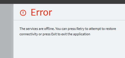

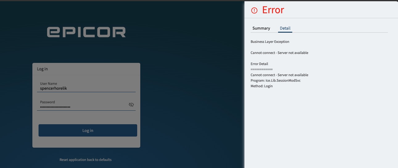

We have an urgent/critical ticket with Epicor assigned to their cloud team. All of our users are experiencing issues. I’ll attach some screenshots of the examples
Update: “We are checking the issue.”

We’re now getting server offline too. Bad to worse.
