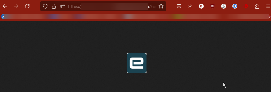

Kinetic won't load - sits at white screen or spinning blue circle gets stuck

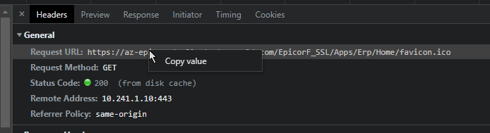

I wonder if that’s what the issue is. It can’t load that icon (throttling maybe?) Or something like that, and it just hangs. That would be stupid… but???
This is me totally guessing here, hopefully someone who knows more than me can chime in.
That can’t possibly be it, can it?? That would be insane.
What does console tab show?
anything else in red?
No the rest of the screen is blank
What’s interesting is when I first launch it all the tabs are blank for quite awhile. I have to let it sit before anything shows up.
So for this user, after the update, the client worked fine. Then yesterday, spinning wheel of death, cleared the cache and it worked fine all day. Then today, spinning wheel of death again.
If you go to the headers tab of that last call, copy the value, then paste it into a browser, do you get something?
I do notice that it notes that it’s coming from the browser cache. Not sure if it’s relevant or not. But I had the white screen problem for a while after we upgraded, but it’s since gone away. I haven’t done anything different, but we don’t get upgraded every five minutes being on prem and all.
Well now the screen is just blank.

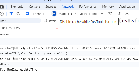

You can disable cache on the Network tab, then it will reload all from server. The thing is that after the files download the code is not showing to make any server calls on others screenshots.
