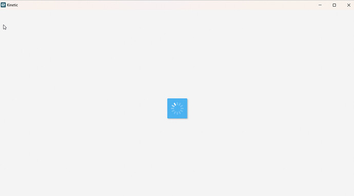

Kinetic won't load - sits at white screen or spinning blue circle gets stuck

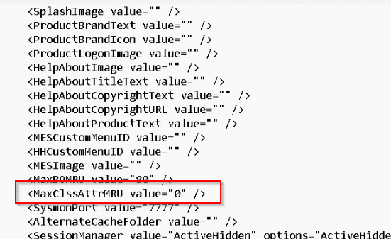

I think you also have to set MaxBOMRU value to 0
Tim writes above to set both values to 0
Maybe this is the important difference
Why though. Moving that file makes no difference, its only the other one that has to be moved to fix the issue.
Tim suggested two settings.

I understand, but those settings correlate to two different xml files in the cache. In our testing, moving the BOMRU file does not solve the problem. Only the class file has to be moved. So that would seem to indicate that only the class setting is relevant.
