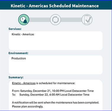

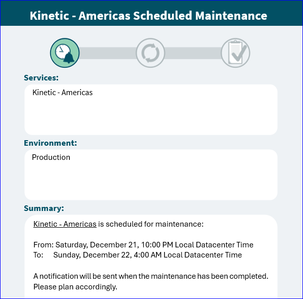

Why can’t they tell us what they’re fixing??
Please let it be this bug before I literally cry.
Or the grid jumping… I’d settle for either at this point.
Exactly. They seem to be doing that more frequently with NO explanation.
