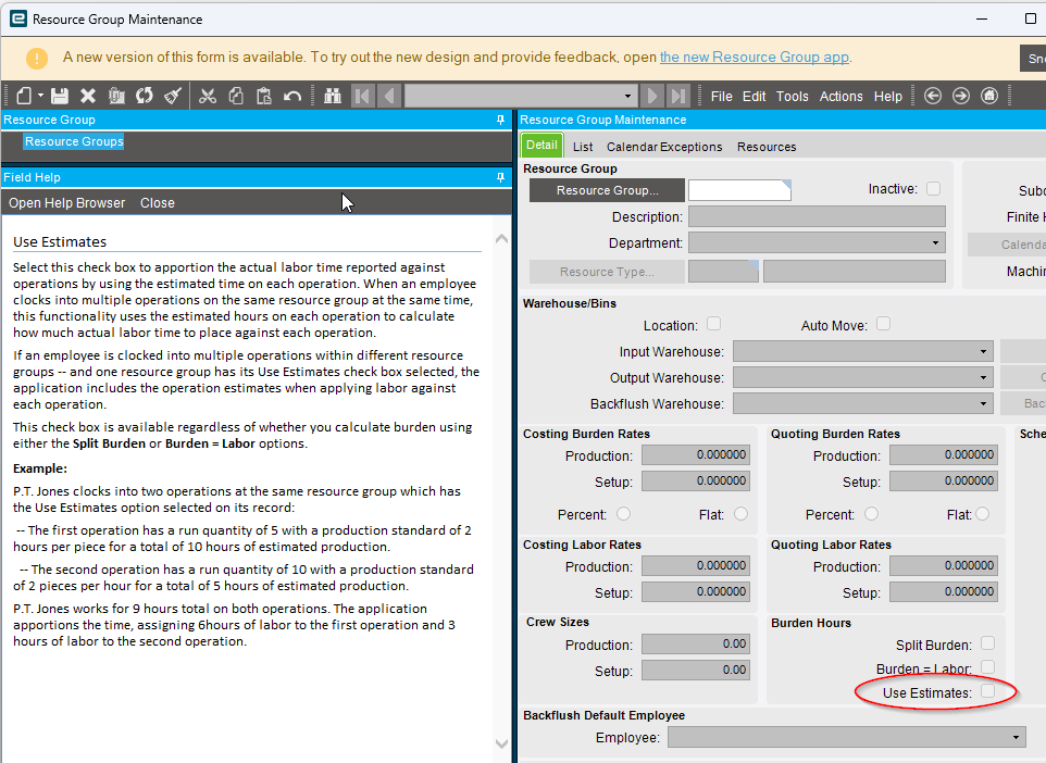

Am I understanding this correctly, that it will take the proration form 50/50 and base it on the estimates? In the example there, it didn’t bill 9 hours of labor to each of the jobs, it did 6+3.
What I’d like to have happen is that the full labor amount is put to each of the jobs, so that if I’m reviewing costs, I’m not short changing the sales price of the product because I’m pro-rating labor. There will be times when I have to run that part alone, and I don’t want to show a loss because the product cost assumes my operator is doing two things at once.
I believe you would just uncheck the box if you want the full hours charged to both jobs, but I am not positive. Probably best to prove it out in your pilot environment to confirm, or maybe somebody else here knows for sure.
You want Burden = Labor to be selected. That will force the Labor time to be 100% of the Burden (machine) time.
