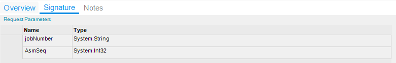

I’ve added a button to the top of the Assembly Details page within the Job Entry that is supposed to add 1 labor quantity to the operation. The issue i’m having is it loops around 3-6 times adding Labor Quantity each time. I can’t find anything in my code to signify this, any advice?

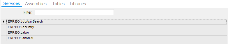

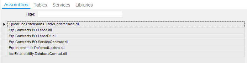

var context = Ice.Services.ContextFactory.CreateContext<ErpContext>();
using (var lbr = ServiceRenderer.GetService<Erp.Contracts.LaborSvcContract>(context))

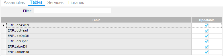

AsmHead.AsmCompDate_c = DateTime.Today;
AsmHead.AsmComplete_c = true;
this.Db.SaveChanges();
catch
// perform actions if there is an error
I’ve created a few UD fields to hold data within the JobAsmbl table. I’ve also been having issues with the Session.EmployeeID as it only works on the first loop and returns null for the employee after the fact.
