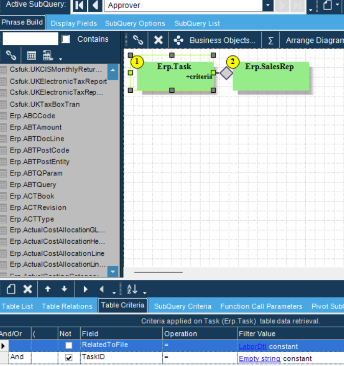

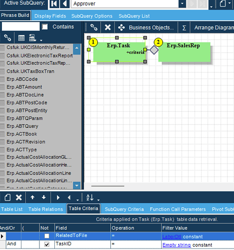

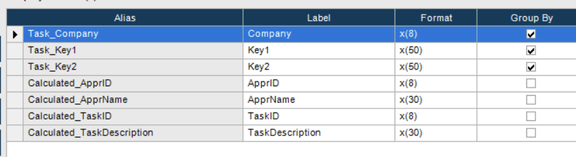

I got something workable, with a Subquery that goes after Task:
Approver ID, Name and such are Max() fields because there may be more than one Task record for the same LaborDtl record. (I found 5 for one which had been rejected a few times)
