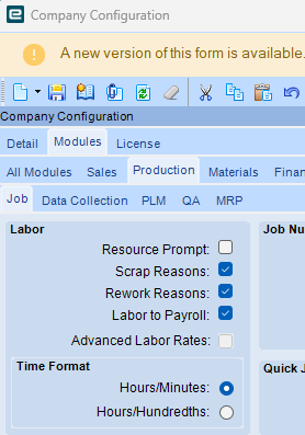

Sorry Patrick, we have been closed for Easter. I got really excited when I saw your response but have had a look and that box is already checked and the records are still not saved to LaborDtl
