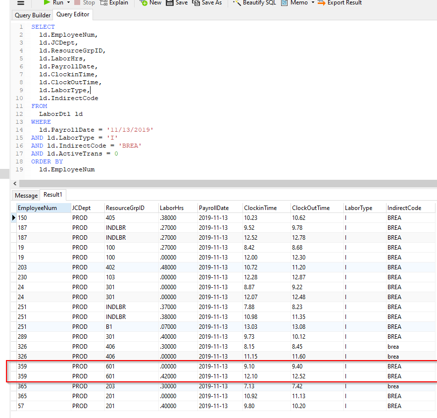

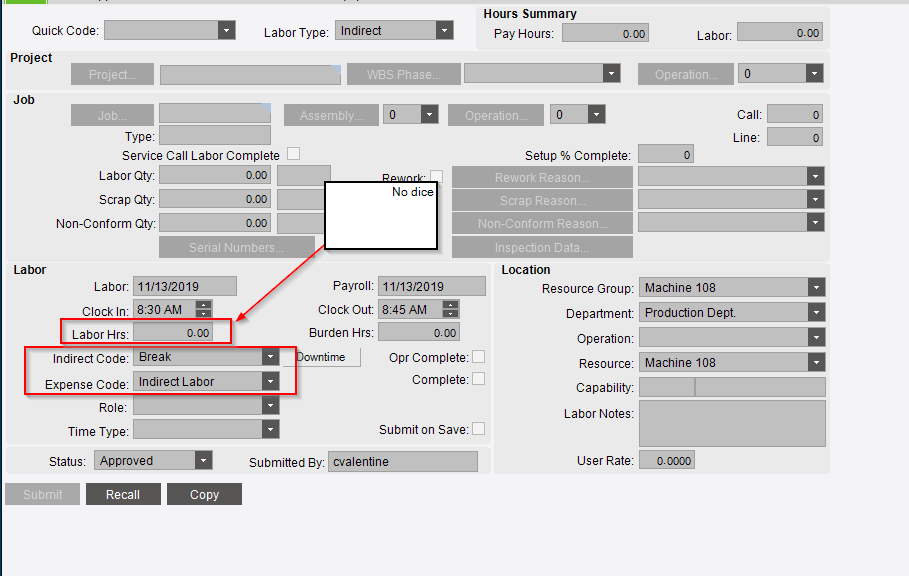

Has anyone seen before where labor hours do not calculate correctly. We use an indirect code for Break time and I have two records for today where the employee setup and resource setup are identical but for some reason labor hours were calculated on one but not the other. I’m not sure if employee or resource setup play a roll in it, but I wanted to at least rule out different configurations of each. See what I mean below.

Yeah I know midnight can cause some issues for sure, unfortunately in this case these two labor records were both today late morning. Out of the entire day I have many breaks that contain hours and many that don’t. Even in this case noted below same user, same resource, same date, just different break times one calculated the other didn’t.

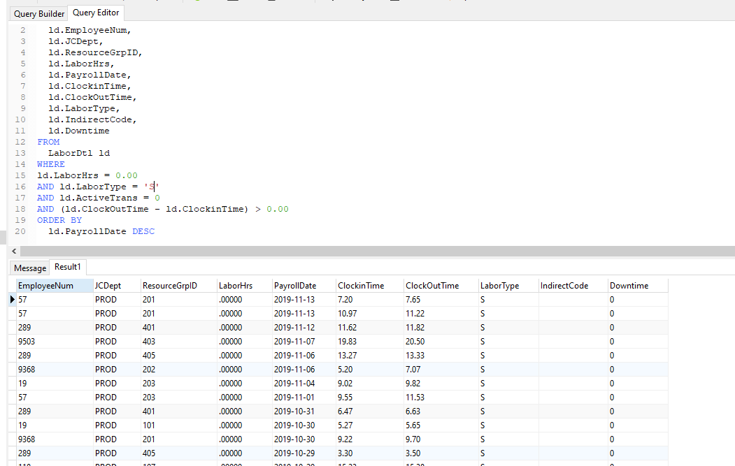

It’s happening to setup records too. Super

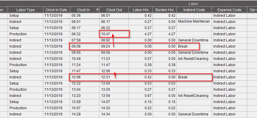

When Employee 1 clocked into the indirect, was he/she also clocked into a job at the same time? What about #2?
Charlie
By god you might have hit the mark there. I never even made that connection that explains why Downtime doesn’t get LaborHrs too because it’s during a production record that they create that record.
