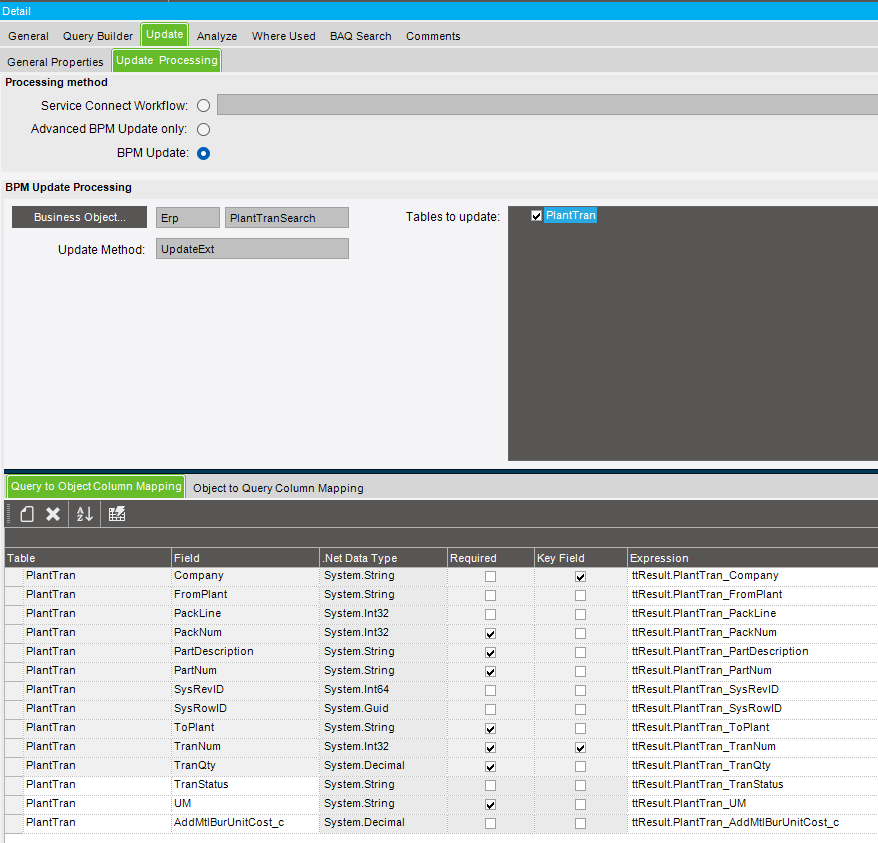

  3. Create an updateable BAQ on PlantTran to update the UD field in Plant Tran. I wasn’t able to get my UBAQ to work in the kinetic grid to actually post the update, but, you still have to have it because otherwise the kinetic grid is not editable. It ended up being a little complicated because I am pre-calculating the potential distribution of the freight by either quantity or weight, so that the user has the option to accept those distributions OR manually type in the distribution they prefer. I believe this is why the kinetic grid choked on it (either the subquery, the calculated fields, or both). But haven’t had time to get support to accept a bug.
  4. Create a function you can use to pass in the additional cost value and transaction num, and update the plant tran table, since the UBAQ doesn’t work in Kinetic.

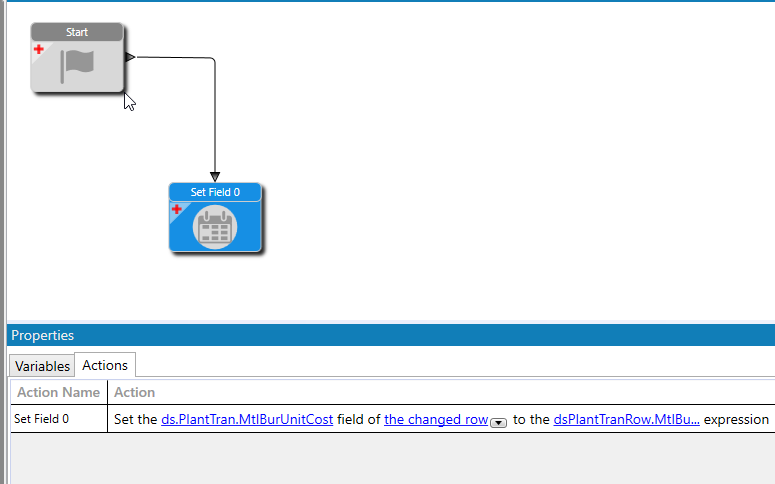

  1. Add a preprocessing BPM on Erp.BO.TransOrderReceipt.CustomUpdate. When you ship a transfer order, a record is created in the plant tran table with the cost components that represent the costs of the part in the sending site. This BPM is to take the field in plant tran that contains the material burden cost element, and add in the value from the UD field. That way when the receipt processes, it is incorporating that additional amount.

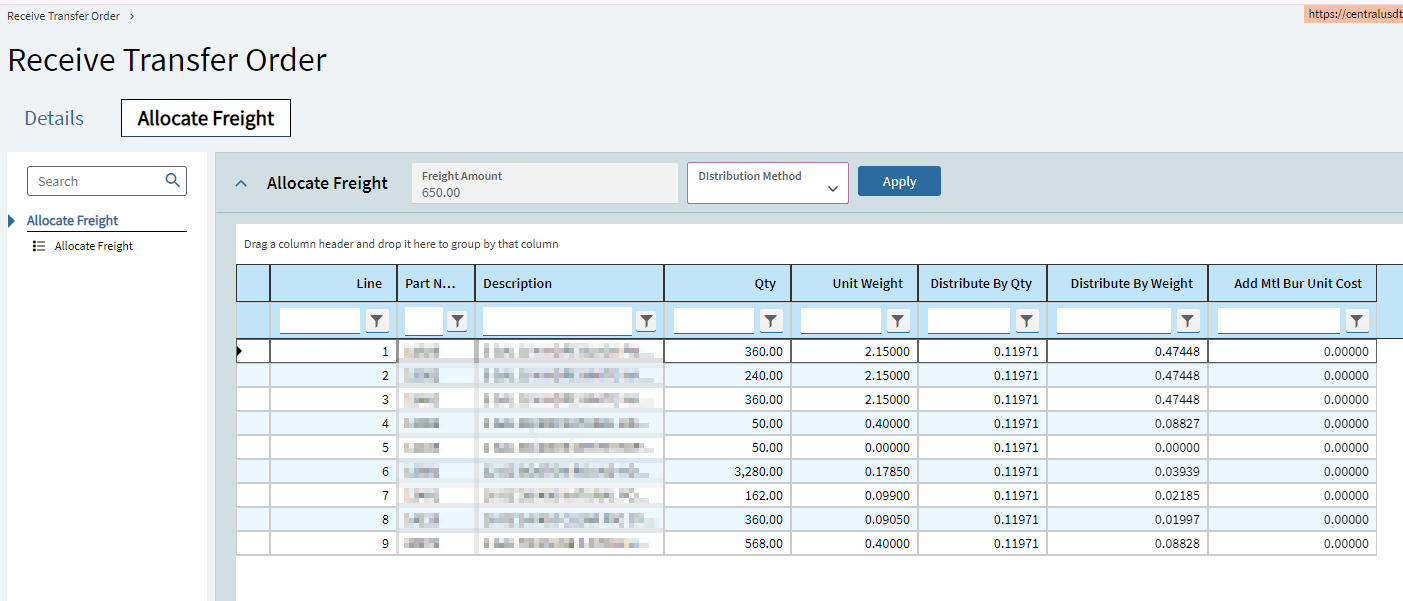

  1. Add a layer to Erp.UI.TransOrderShipEntry. Add a control that allows the user to type in the freight amount (bound to the UD field on TFShipHead).
  2. Add a layer to Erp.UI.TransOrderReceipt. This layer ended up being pretty complicated to build because the base application has some difficult (or impossible?) to evade logic that prevented me from simply sticking my plant tran UD field into the existing interface. It demands a receipt date when all you are trying to do is update the UD field. So to get around that I just added a separate tab with its own panel card grid which ended up being nicer anyway I think.
  • Add a new tab page for the landed cost controls
  • Add a panel card grid. I used the provider model to hook the grid up to my updatable BAQ so I could make the UD field on plant tran editable.
  • Add a combo box so they can pick whether they want to distribute the freight by quantity, weight, or manually.
  • Add a button for the apply command.
  • Add an on click event for the button with a data view condition to iterate through the rows in the grid.
  • Add an iterate event to send the transaction number and desired freight cost over to the function to actually save the value in the UD field, since the UBAQ doesn’t work.

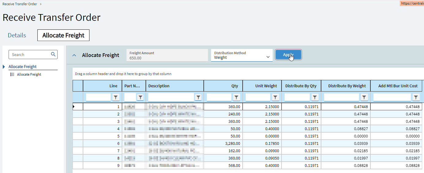

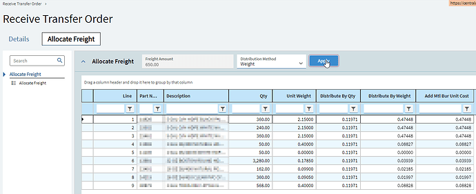

That’s pretty much it. Once they have applied the freight they can receive the transfer order as normal.
After selecting distribution method and applying:
