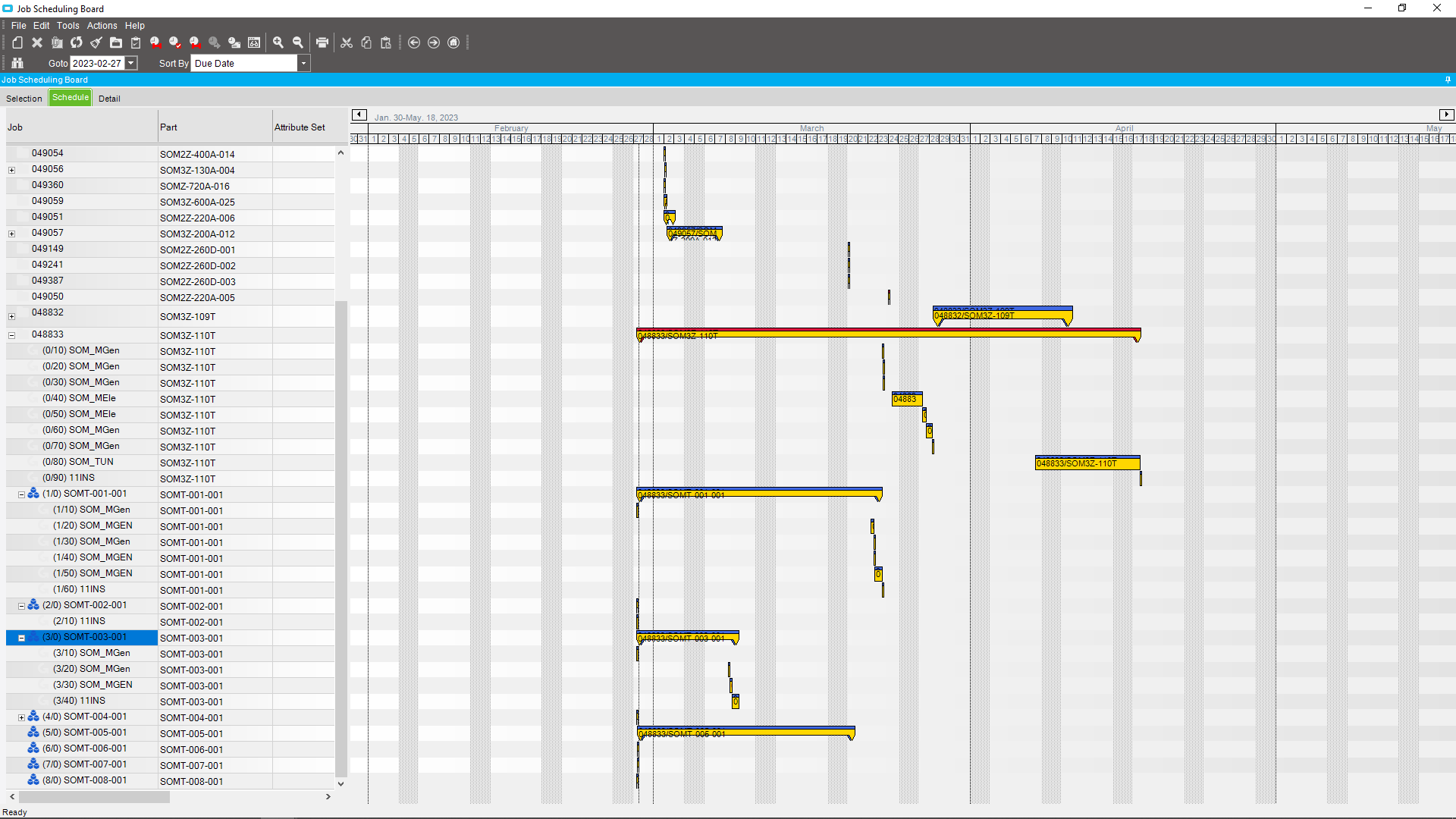

I’m currently experimenting with the scheduling and MRP modules in Epicor 10.
Since our company used EPICOR for a while without making use of those features, I had to create a whole new set of operations and resources to hopefully get isolated from the previous setup.

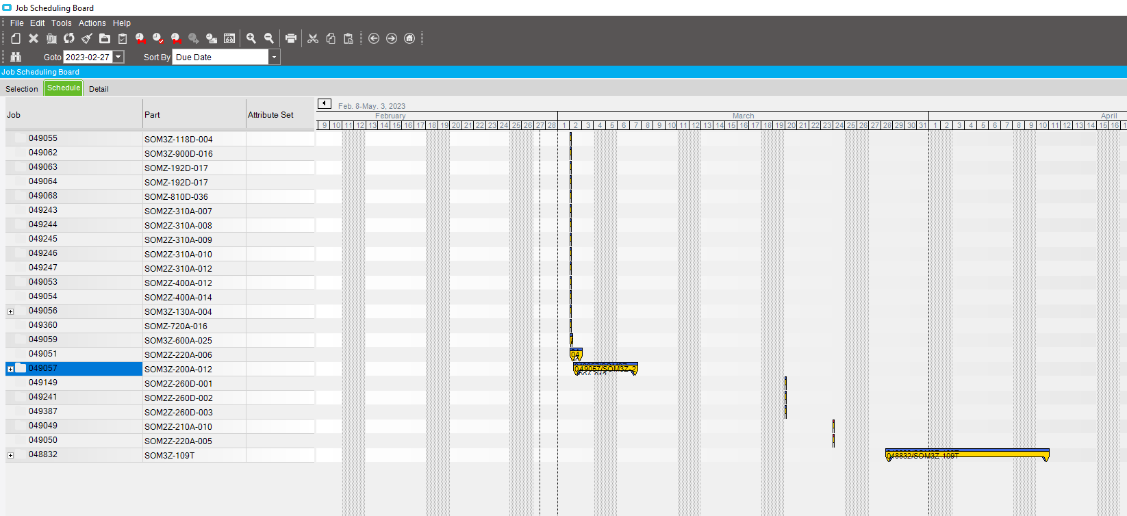

I’ve been encountering large gaps in the schedules (see captures attached, between march 8th and 15th)
We use finite scheduling on all resources and haven’t configured any material constraints, setup times or move times.
This job was scheduled using backwards scheduling.
Has anyone experienced similar issues or can give a hand?

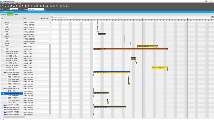

I’ve tried forward scheduling and the gap is still present.

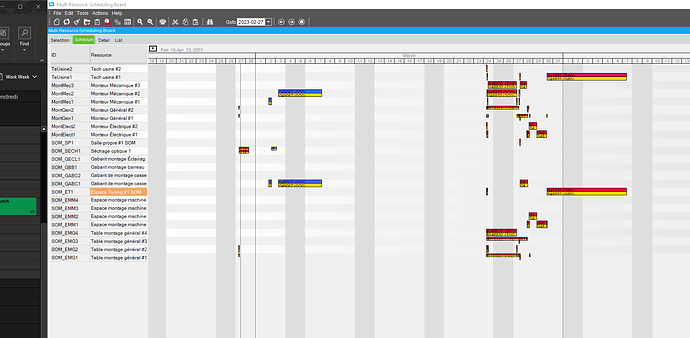

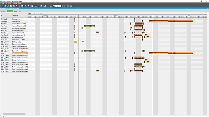

Following up on the theory that there’s not enough demand for work, i’ve set up a second identical job with a required date of the 20th of march. The gap is still present in both jobs (see image)

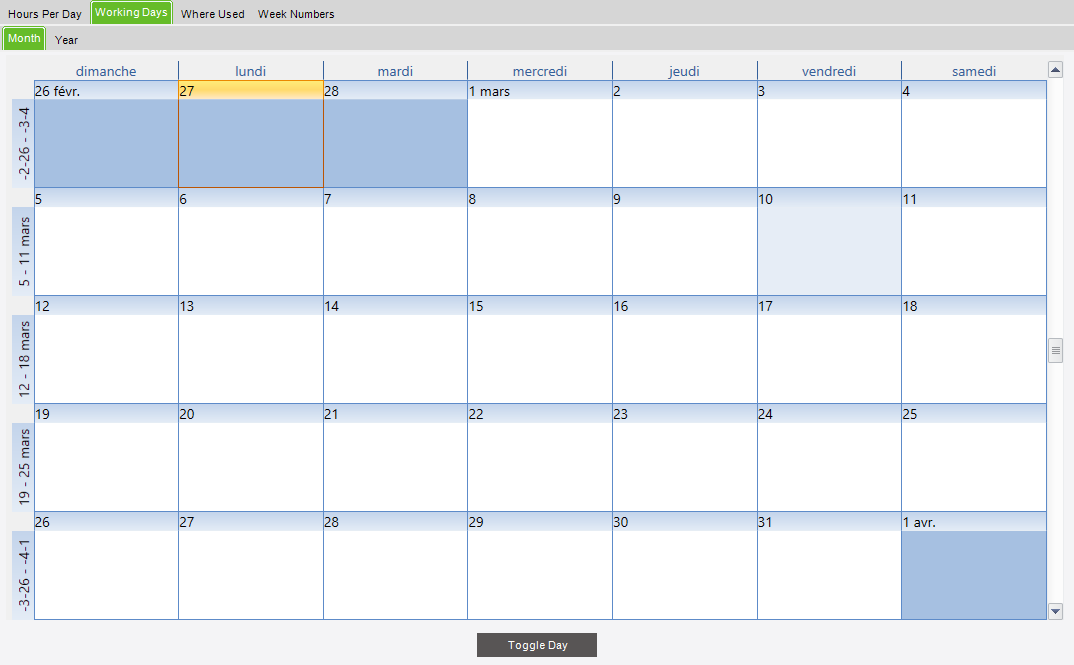

And you’ve checked all of the Calendars - Company, Resource Group, Resource, and Employee? (because there is a hierarchy to the calendars)

Concerning calendars, i’ve set our standard production calendar to the resource groups and left the resource calendar themselves blank. Employees aren’t linked to resource currently.

After some more testing and investigating, we realized we had a stray material that had the material constraint field checked. That coupled with the close due date seemed to have created the weird gap in scheduling. Removing the constraint on that part fixed it as far as we know.
