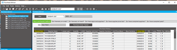

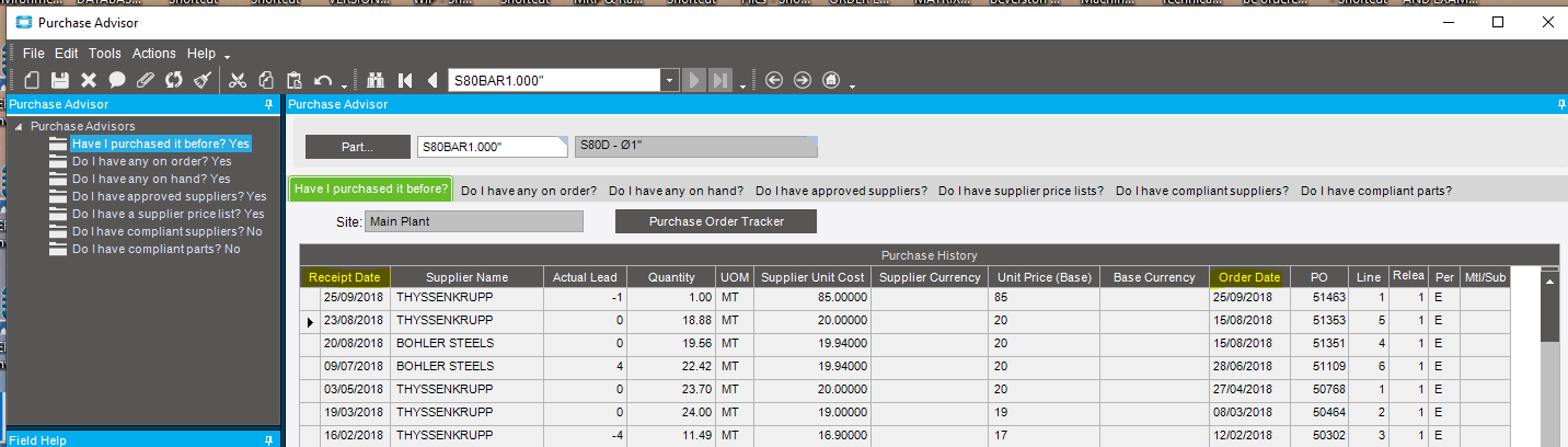

may i ask why not using Purchase advisor Epicor Custom View as it is already done that for you?
Hi Al, thanks for your reply. I am trying to put together a report for all our parts qtys, values etc to run before and after our annual stock check. One of the fields I have been asked to include is the last purchased date. I looked at the purchase adviser as shown in your screen shot, but could not work out how to get the most recent date into the BAQ.

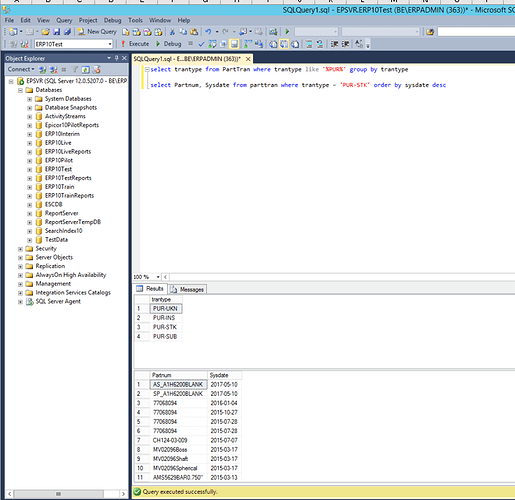

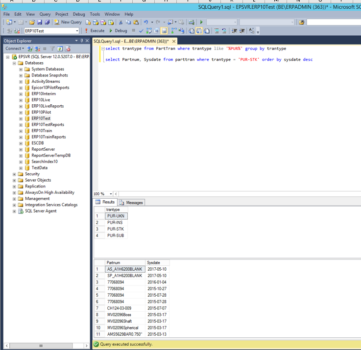

the easiest way to create a subquery based on PartTran table filter it to ‘PUR-STK’ trantype or/and the relevant criteria to your environment i.e. your business task/process rules, then groupby company, partnum, trantype, to return Max. sysdate, this will return the latest transaction date which is in my environment the latest purchase (received to stock) date
this is a custom tracker view i.e calculate, filter and display these values -on the fly- or/and on an intermediate tables i.e. not direct call from any Db tables, that is why you wont be able to call it, you are doing something similar when you use subquery/groupby but to suit your need within your BAQ
