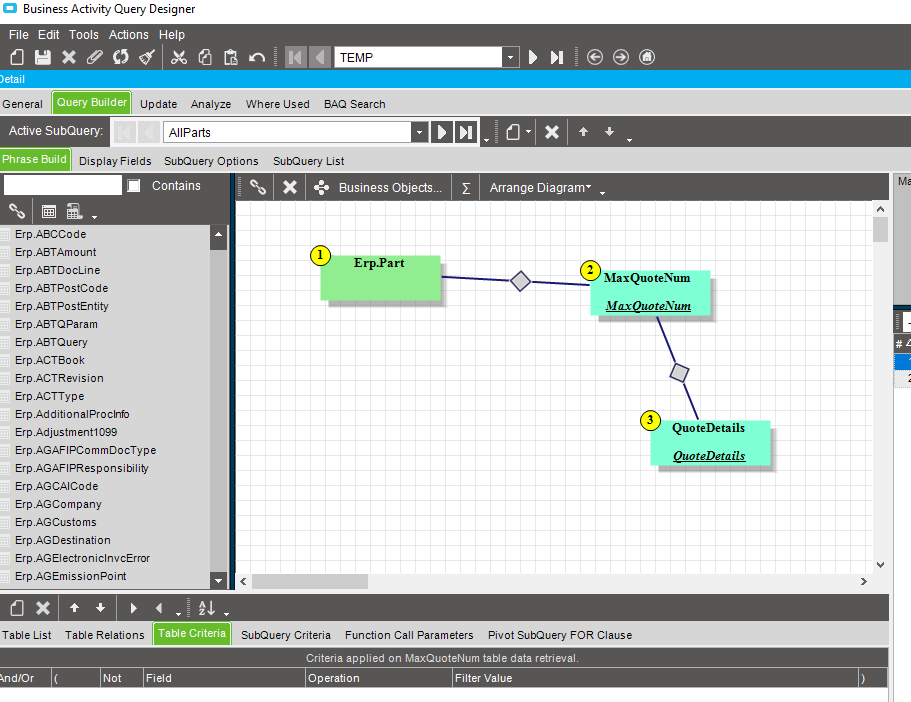

There are probably other ways to do this, but this is how I would. You need to have three queries: 1) your top level, “All Parts”, 2) an innersubquery called “MaxQuoteNum” and 3) another innersubquery called “QuoteDetails”.
1 & 2 are connected via PartNum
2 & 3 are connected via MaxQuoteNum and QuoteNum (see below)
The MaxQuoteNum query is simply the QuoteDtl table, grouped by PartNum. Then, a calculated field called “MaxQuoteNum” is added.
For the third query, you simply add QuoteDtl again, but this time added in QuoteHed (to get the QuoteDate)
Finally, back on the TopLevel query you’ll need to display all of these fields from the subqueries.
